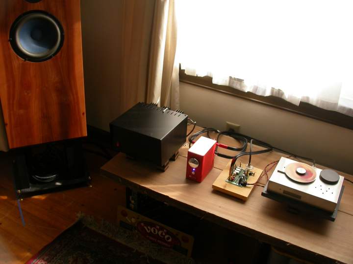

Big grins... running the new TWO with the Astron, dead silient on my AN/E HE's (I think these are around 96db...) I'm running my DAC off a car battery... I'll probably try running the amp with a battery set up when I get a chance to do it. Everything working perfectly right outta da box. Best wishes, Seth, GREAT PRODUCT! Mike in Seattle

Zman, same to ya!  :drool: So here's my first testament... I listened to music alll day yesterday, some at the altar, some just via the sound that filled my house. I had been running a Sam Kim el84 based amp... the sound out of which is achingly beautiful. The Virtue, different attributes--- really coherent and with great definition  from top to bottom, excellent control of bass (something my 7 watt tube amp was a bit challenged at), surprisingly to me... the V2 don't solid state at all... it almost has the best attributes of SS and tubes... so some of yesterday I spent listening to "modern classical".. the gentle sweet stuff I normally listen to that sounds so good via my EL84 gear... but I got totally... gobsmacked listening too more dubsteppy bass content zippy lectronicy stuff too... the V2 did the gentle stuff slightly different than my tube gear, but it did the dynamic stuff sooo much better... Another surprise... I could get plenty of volume with my tube amp with the vol at 9 oclock... my speakers are supposedly 98db efficient... but after 9'oclock, my system would start to struggle...  I was a little worried that the V2 powerhouse might be a bit much for my speakers but nope. I can dial to 12 get the same volume, but it's cleaner so I can go a bit louder but with more dynamics! Ha ha, now I'm just laughing at the whole thing... I paid more for a pair of preamp tubes than I did for my entire V2/Astron setup! GET OUT! None of my friends will believe this. Anyway.... I have no reason to tweak the V2, but of course, I will... Batteries, Attenuator, Cords etc... just for the fun of it. Will keep you posted.

Love what you've got going there!  Love it even more if you buried that Astron under the plank.
Big hugs and thanks for posting pics and listening impressions!

Seth.. I love the look of that massive Darth Vader PS... I'll add a "DANGER HIGH VOLTAGE" sticker and it will be perfek.
