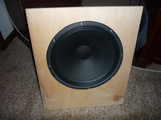

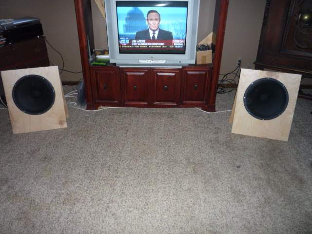

Hi folks.  First time poster, long time lurker.  After much deliberation I've finely got around to building my first OB.
At first, I had thought about going the fullrange route.  But I was looking for the simplest build possible and happened upon Hawthorne's site.  He incorporates a coaxial unit in his designs.  Not guite "fullrange" but the idea was intriguing.  Also, the 15" coaxial could be run full range without a sub in most cases.  To me, this seemed the simplest and most cost effective way to get my feet wet in the OB world.  So I ordered the 15" Silver Iris'

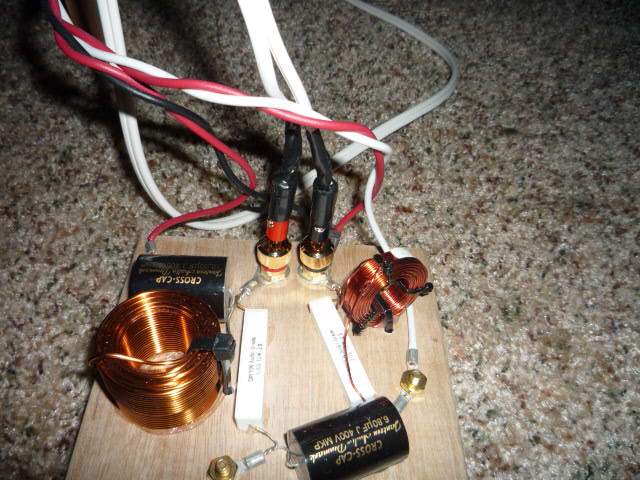

I was pleasantly surprised to find what the Hawthornes have packaged for $170 per speaker.  The coaxial includes a very nice crossover assembled on a piece of mahongany!  A nice touch.
Anywho, after a couple hours to assemble a simple baffle, the Iris' were ready to play.  So I hooked them up to my Sherwood  :oops: receiver and they sounded guite good. Lately, however, I've acquired a MiniWatt N3 and have burning it in on the Iris' for the past couple days.
So far this system has met and exceeded my goals of finding a simple OB that sounds great . . .and for what I would consider an extraodinary value.

After some extended listening some things have become apparent:  These big 15" paper cones throw up a very nice soundstage.  Lively, and surprisingly detailed (Previously I've owned Monitor Audio and Ascend Acoustics, along with some Klipsch La Scalas man years ago).
Anothe surpirse is the compression tweeter.  This is the entry level set-up so of course I was conerned there might be a bit of harshness/honkiness . . . but the Eminence tweeter is actually quite sweet; blends in nice, not calling attention to itself.
Considering cost and relative ease of set-up . . . I really can't ask for much more. At the risk of sounding like a fan-boy I'll leave it at that.  One more thing tho, I've been listening to music that I never listened to thru my previous speakers.  The Iris' sound nice with a wide variey of material . . . even recordings that are less than ideal.
