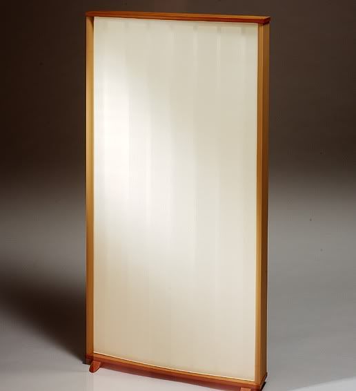

I use a Furutech RWL-1 Tuning Panel on my ceiling, centered lengthwise between my main Lorelei's @ the 1st reflection point. Along with having 2 of these Furutech diffusion panels on the 1st reflection point of the side walls, they help make my 11' x 17' room sound way larger than it actually is.
