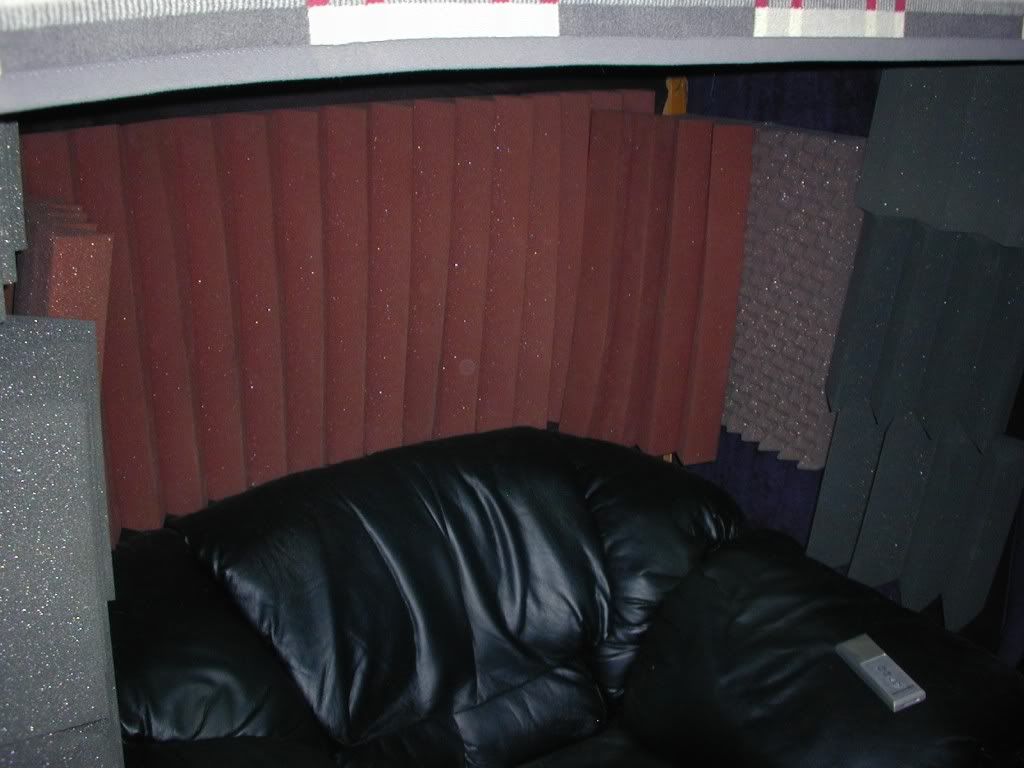

Great Experiment!!
I have been experimenting with similar acoustic systems for MANY years.
I must say, I haven't used "rockwool".  Can you offer a source?
The "moving blanket" suggestion is also a good one, and I have found a distributor of blankets that supplies me and my clients.
One of my experiments involved "hanging" the moving blankets from the ceiling and forming a listenting TENT that enclosed my listening chair.  Obviously the tent was fully open to the front.
The sonic improvements were incredible since it blocked/reduced a portion of the reflected sounds from side and rear walls, as well as the ceiling.
That has since given way to a LISTENING CHAMBER
Contrary to what many tend to beleive, your room damping and the listening chambers as above DO NOT damp the highs.  It is just the opposite.  Since reflected high energy that distorts the recorded sound by adding "room reflections" (room added distortion) is reduced, the highs directly from the speaker become MUCH MORE clear and musical.
The sonic becomes much more similar to "headphones with a soundstage and imaging" in its purity.

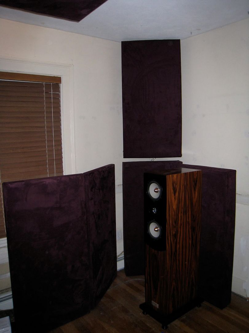

I don't have the angles, but I have some absorption.
Here is the front left corner.
Part of a ceiling panel is visible in the photo.  There are (4) 4" thick 24"X48" panels on the ceiling.  The side wall panels are 2" thick, and the other (14) panels in the room are 6" thick.
Still haven't refinished the floors or patched the walls or painted.    :D
Your rooms look great, BTW.
bluemike
Re: Experimenting with Dead End Live End.
« Reply #14 on: 7 Feb 2010, 12:22 am »
Nicely done !
