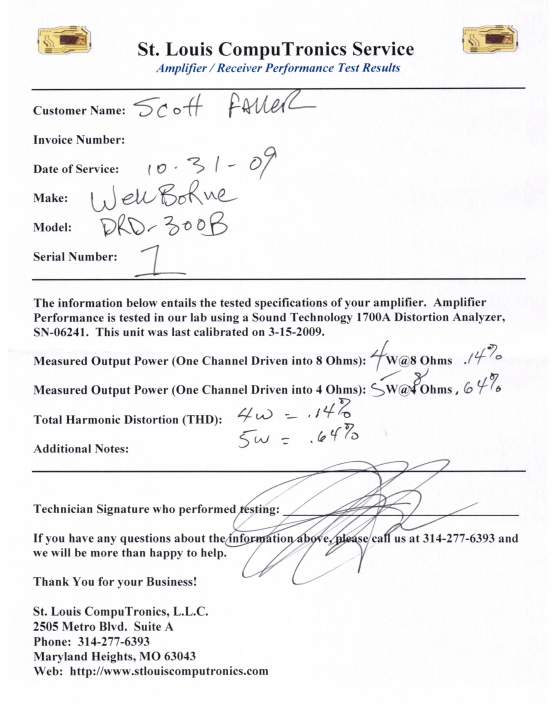

I just find it slightly ironic since SE amps measure among the worst in the traditional THD sense.
You know, not all SETs horribly high in THD. A month or so ago Tekwiz held what used to be known as a McIntosh clinic. A bunch of us brought our amps in an Jeff measured them in the same way he used to way back when at the original MAC clinics. I took my 2A3 and my Welborne 300B DRD. Much to my surprise, then didn't measure half bad at all.
Full out my 2A3 did 5wpc into 8 ohms at 3% THD. On the other hand my 300B DRD amazed Jeff. at 5.5wpc it measured 0.64% THD. This was full output, pushed any harder the waveform clipped. At 4wpc she measured in at only 0.14% THD.
There is something about that old Lofgrin White circuit that is just right. It comes though as purity of sound. The great part of the DRD is you have only one passive in the signal path, a resistor (not counting the tubes and the xfmr).

That is very impressive! Especially the Welborne. I'd love to see how the amp I put together would do. The highest distortion % wins right?  :green:
