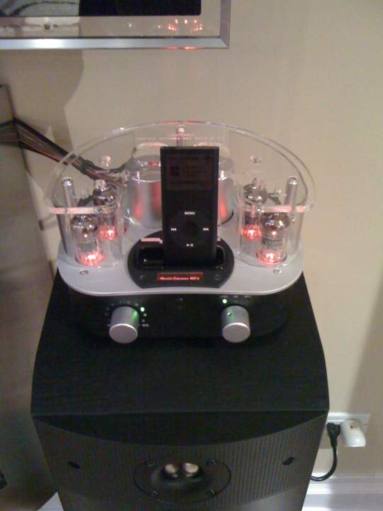

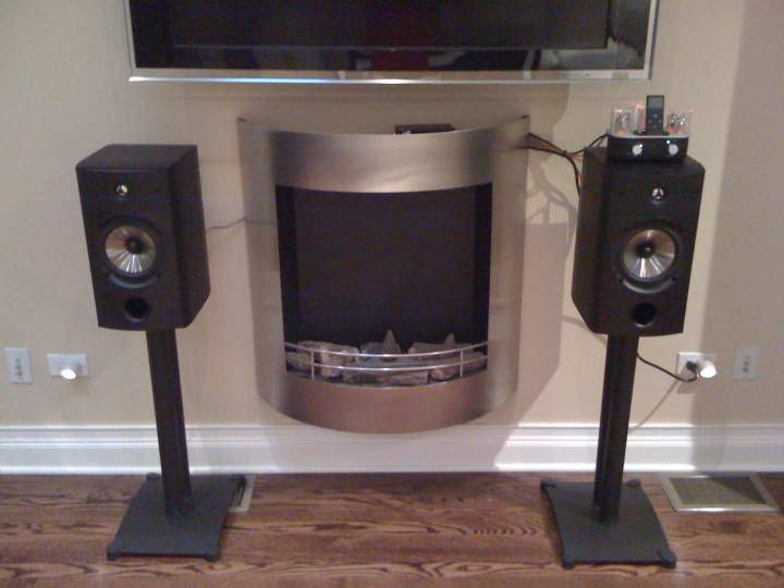

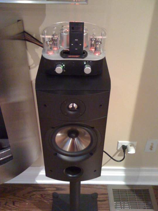

I have this following setup, MC4 with PSB B25 speakers.  The combo sounds very nice, however I'm lacking a lil bit of bass so I'm going to purchase this sub http://www.amazon.com/Polk-Audio-Compact-Powered-Subwoofer/dp/B000P0528U/ref=sr_1_3?ie=UTF8&s=electronics&qid=1264347478&sr=8-3 now since I have the Roth Audio Music Cocoon MC4 I couldnt locate a sub out on this lil system so I'm  curious as to how can I add a sub to this two channel system?  :scratch: Any help will be greatly appreciated!

From the look of the connections avaiable on the sub, I would be running the speaker wires from amp to sub, then on to speakers.
This will allow you to trim out the bass from the 2 speakers, and let the sub do all the bass talking.

Thanks, do I need any special cables?

Well, if we briefly avoid audio nervosa - no.
Just regular speaker cables that will fit into the connectors on the back of the sub amp.
Back to the nervosa - some consider the Xover in the plate amp of a sub amp to be a poor Xover for your main signal to go through.  I have in the past, run a 2nd set of speaker cables from amp, to sub input.  That way the sub plays bass, but the mains run full range.
Your system, your call.

With the Polk's Frequency Response: 38Hz - 250Hz can we really consider this  sub-woofer. Your main PSB's have this Frequency Range
On Axis @ 0° ±1.5dB 59-20,000 Hz
On Axis @ 0° ±3dB 45-23,000 Hz
Off Axis @ 30° ±1.5dB 59-10,000 Hz
Lf Cutoff -10dB 40 Hz
Have you looked at any sub with a low freq range around 20Hz like the PSB sub?
