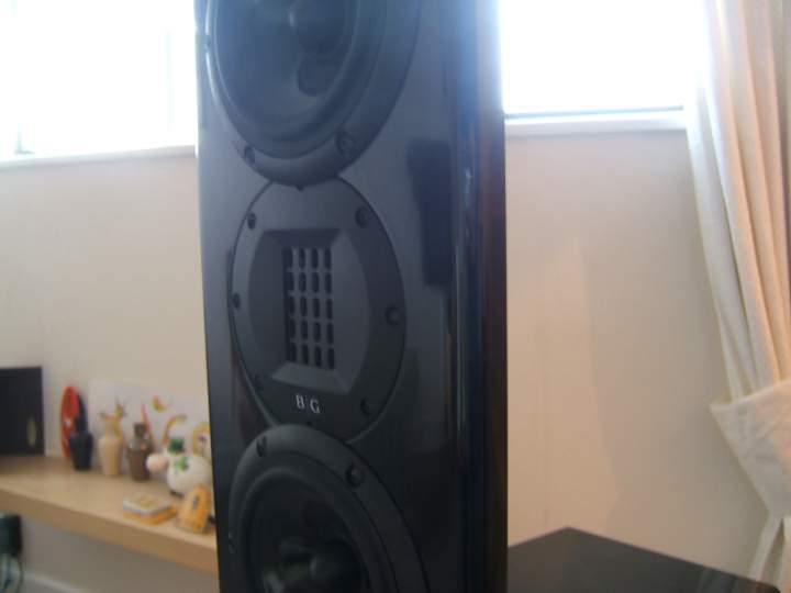

ebag4
Re: 0B7 UK BUILD
« Reply #18 on: 20 Jan 2010, 10:52 pm »
Beautiful job on the finish Brian!  How about a pic from the front.

brian t
Re: 0B7 UK BUILD
« Reply #19 on: 20 Jan 2010, 11:00 pm »
just for you ed
