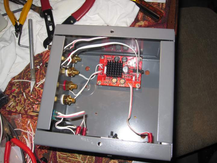

I just ordered one of the mini amps. :D For $55 why not? I really like using batteries to eliminate AC noise issues. If it doesn't work out, I'll have a serviceable backup amp. All of the other amps have much more power than I need.
I'll be using a sealed 12V 9.0 Ah battery that is buffered with multiple caps . If this little amp meets my requirements I'll bridge it and order another one. I might experiment with lithium batteries too, to hear if they affect SQ.

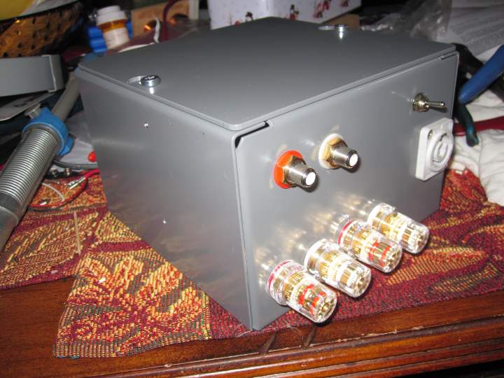

6"X6"X4" Electrical box (Free)
