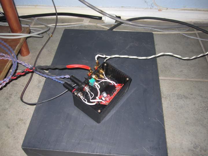

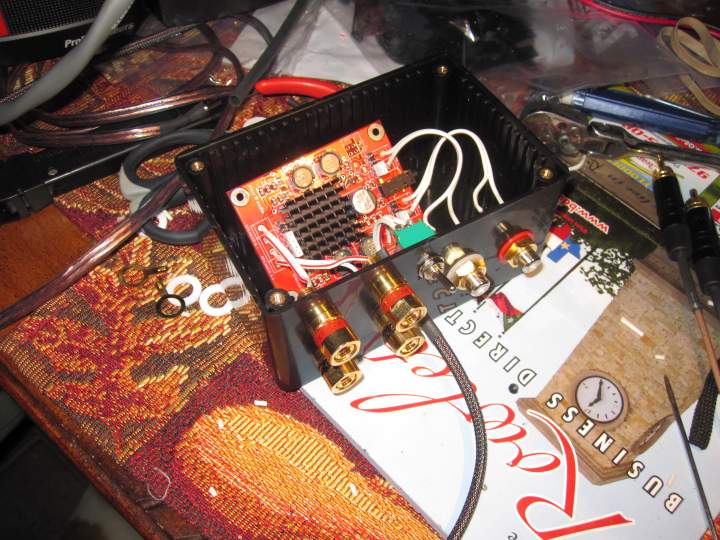

TrungT
Re: $175 Class D amp--120 wpc
« Reply #3379 on: 9 Jul 2012, 07:30 pm »
 :thumb:
24V sound very good,and yes, it's a keeper.
I'm still "breaking in" new S/O Mundorf caps on the speakers, 2 more weeks 24/7 to go.
Will move to a metal chassis soon.
