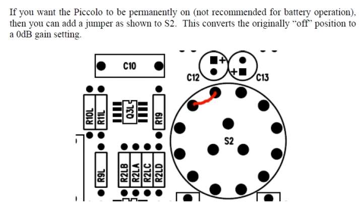

Would I be right in assuming this idea is a no-no ? - Unlike the load impedance switch it will need more than just a jumper and an on/off switch on the power supply to fulfill its role in the scheme of things. The reason I ask is that I have tried it and it doesn´t seem to work so I am waiting on a new rotary switch to arrive from Digikey to go back to the original brief.

If you're just wanting to have a zero gain setting (without the battery pack), the jumper should work. That's what I did with my Piccolo (soldered a jumper) and it works fine. I used the switched circuit on a power conditioner to turn the Piccolo on and off.
Did you use this diagram for the jumper? And did you disconnect the battery supply leads?

No, I didn´t need the on/off either ´cos I have the bugle power supply with switch but I wanted max gain at 26db rather than zero gain.

You can permanently jumper in one set of gain resistors.  Then the switch is not needed.

Thanks Jim, do you have a photo or an explicatory diagram of how to go about it. I must have done something wrong

Did you find out how to bypass the gain switch?
