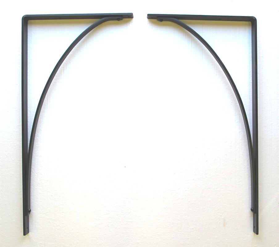

I designed some table brackets for a friends home office and they would work perfectly as a turntable support too. We made up 2 sets, the pair shown below is made from 1.5" x .25" steel, the arch support is riveted at each end. The second set used 2" wide steel for a more massive look and would easily hold up 230 lbs.
The brackets are 36" x 18" and look great when installed, a lot better than chrome angle brackets, though I suppose they could be chrome plated.
I work with a local blacksmith, perhaps there is one in your area that could make similar brackets. I could have a pair made for you but they would need to be crated and shipping would be expensive. Go local if you can.
Wayne

Very nice looking brackets Wayne! The brackets I am looking at from Lee Valley are not quite as large as they measure 12"x15" and are 1 3/4" wide.
I believe three of them should have no trouble supporting the weight as the folks at Lee Valley tell me they hold over 100 lbs each quite easily. they are also quite fine looking IMO (and less than $20 each).
