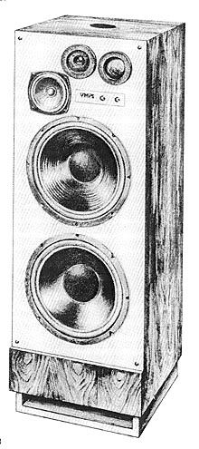

Clay Monkey,
Here is the "stock" TOWER II cabinet look and Driver Array configuration.

Clay Monkey,
Thanks John!  That is a good start.
If the drawing is to scale, I should be able to get a basic idea of the dimensions from it.
James, is this the driver arrangement that you were talking about?

« Reply #14 on: 21 Jan 2010, 10:00 pm »
Dimensions are 43"Hx14.5"Wx17"D, construction was 3/4" MDF throughout.
Great!  Thanks Brian.
What about that bottom foot?  I'm guessing it is open in the front and is where the passive fires into?  Is that included or how do I size it properly?

« Reply #16 on: 21 Jan 2010, 10:34 pm »
WARNING!  DANGER WILL ROBINSON!  Pairs must be mirror imaged or you are in very deep quicksand.  Sound best w/ tweeters on the inside unless they are spaced very very closely (like 2-3').  Yes those are the arc array that myself and others prefered over the later SE versions, which incidentally were shorter lived.
I'd LIKE a pair of those, but the ST/R are about twice as big and that much better.  Whose got room for a spare pair of older speakers THAT huge?
The 17" depth includes the kick panel below and the grill; minus those pieces yields 16-1/4, but these minor differences are uncritical.  I still recommend greater PR area than the OEM single 12 (1x 15, 2x 10 or 2x 12).  I found good audio results side-firing the PR sans slot loading.  Some like Theil and one popular current lower cost brand even front fire their PR.
Toss the toggle switch; if biwire/biamp option is desired just hard wire to separate binding posts and parallel them externally for single wire.
