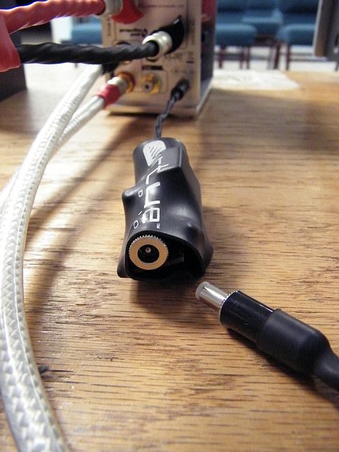

Since were on topic of new circuitry, here is what the soft start's will probably end up looking like

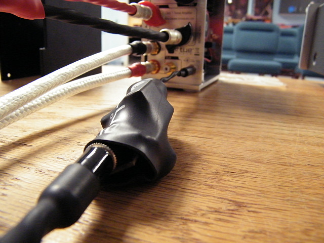

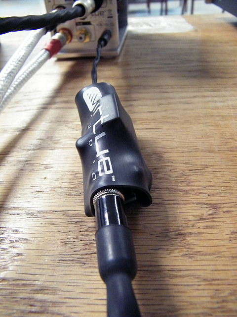

You know how excited I am about these new high-current power supply options.  Well, to make them work on the 2009 products, and not fuse the power switch, you're going to need a soft-start circuit.  Rather than making you open the unit and start soldering something onto the power switch, we're creating an external unit.  You just put it between the amp and your power supply.  It's a bit crude looking, but works well.  Electrically, it's 100% the same as what we've put inside the new ONE.2 and ONE "classic."
