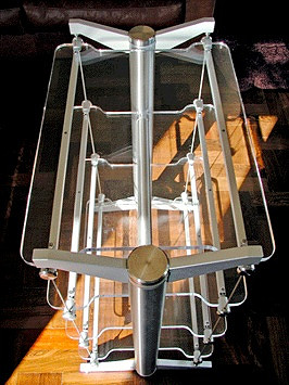

Having, like many of you, built a DIY equipment rack, I am always fascinated by unique design approaches.
I received the latest version of the Audio Advisor catalog and came upon a full page listing titled "Hear What You've Been Missing" for the Stillpoints 40-26 ESS Rack.  As I read through it, it was quite impressive in it's materials and implementation.
All metal structural parts are machined aluminum (not extruded):  A single 2.5"D post on either side, a pair outrigger bottom feet, a pair of outrigger top hubs and a pair of 3/4" square shelf supports (front and rear) for each shelf.
The shelves are 3/4" dense acrylic and are supported on 1/8" stainless steel cables that are tensioned between the feet and top hub.  The shelves are secured to the cable with set screws containing a captive ceramic ball.
Additionally, there are more ceramic balls under each shelf and under the feet.
I was very impressed with the construction and (probable) isolation, but when I got to the end of the page, there was the sound of sucking air (from me) as I saw the price - $10,245.00.
Has anybody seen one of these, or know a well-to-do friend that has one?  I was thinking about using the design elements in a DIY version, but it would surely be a very ambitious effort.

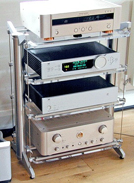

That makes the Arcici rack a deal at $2090.00 http://www.arcici.net/reference-suspense-rack.htm To see it you would be very impressed as I was.
srb
Re: Stillpoints 40-26 ESS Rack
« Reply #2 on: 19 Dec 2009, 09:54 pm »
The rack you have linked to is actually $5500.00, but still less than half the price!
I was intrigued that the only mass that the Stillpoint's shelves physically connected to was an even smaller, lighter 1/8"D cable, yet each shelf could support 120 pounds.
Either approach would need a very solid non-flexing frame.
