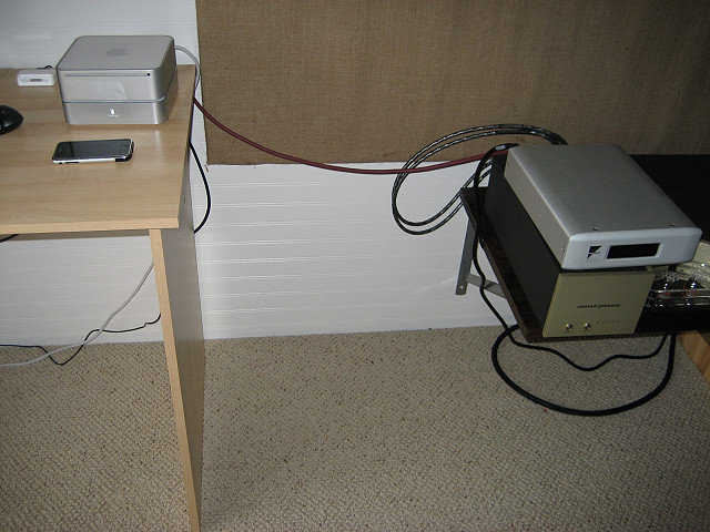

I would suggest the wired approach, especially for you listening room.  I too run an Airport Express from my Mac to other parts of the house with fair results.  Please share the rest of your system.  If you have a DAC/preamp that will accept XLR interconnects then we will have a different conversation.
Below is a photo of my setup, I would run a long USB (brick colored cable in photo) or long interconnects (silver/black colored cable in photo).

Well, my budget such as it is, I am leaning toward the hard-wired approach if I can swing it. I am going to look at other DACs as well considering some of the hi-rez limitations mentioned in re: the Music Streamer.
Is there a preference in having either long interconnects or a longer USB? Or does it matter?
I apologize, I missed the H/K receiver you own.  IMO you are better off running long interconnects.
