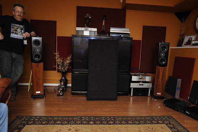

Guys and gals,
I have a 57" rear projection HDTV that extends out about 25 inches. Rives Audio did an acoustic treatment design and there are 1/2 round and 1/4 round plywood difusers covered with Guilford of Maine fabric on each side of the TV. When I am listening to music, I cover the highly reflective face of the TV with an afgan throw. Sometimes I wonder if a little more deflection across the face of the TV might be a better solution. Here are a couple of pictures. There are more pictures in my gallery. Since the photos were taken, the speakers have been moved farther away from the side walls per Cardas calculator. Any ideas or suggestions for temporary treatment of the TV would be much appreciated.

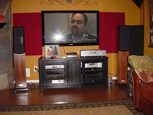

evan1
this is what I do
vinyl_guy
this is what I do

DTB300
GIK or Real Traps can probably make a custom size 2" or 4" thick trap for you on a stand.
I have tried a blanket, quilt, pillows, Auralex, etc. and the 2" Acoustical Cotton Trap I use in front of my TV was far better sounding IMO.

jimdgoulding
Two GIK panels standing against your screen should do you right.  Cost will be around $100.00 and change.  Or, maybe what VA said.  Recommend black cause it disappears better.
I'm not sure what either would do since the TV is forward of the speakers and the speakers face away from that wall. What I can't see in any of your photos is the rest of the room, especially the rear. In my experience, absorption on the rear wall behind you is more important than on the front wall behind the speakers. In my own well-treated room, covering the large RPTV with absorption made no audible difference at all. Which makes sense given the way speakers radiate. More here:

Thanks for your input Ethan and the link to the article. Very interesting and it certainly makes sense.
My TV extends out 25" from the wall behind the speakers and the front of the speakers are 71" forward of that wall so the front of the speakers is 46" in front of the TV. There is a large floor to ceiling book case filled with books, vinyl and some pictures and other nik-naks about 8 feet wide behind the couch. Here is a picture.
There are more pictures of my listening room showing all walls, ceiling and treatments in my gallery here: http://www.audiocircle.com/index.php?action=gallery;area=browse;album=1834
Since I moved my speakers a little farther from the side walls, I am happy with the sound I am hearing--good bass extension, detail and slam; midrange and highs have clarity and there is a sense of air or space around the instruments. I sense a little deeper soundstage when the TV is covered with the throw or a blanket and was thinking that some absorption or diffusion in front of the TV when listening might enhance the listening experience.

ctviggen
  • Posts: 5251
Front Wall Absorption
--Ethan
I hate to disagree with Ethan, but using two of Ethan's own thin panels on each side of my VMPS RM40s nearest my 57 inch RPTV improved imaging and realism quite a bit.  Now perhaps this had to do with effects other than reflections off the TV (such as diffraction around the edges of the speakers), but there was an improvement nonetheless:  take out the thin panels, and the imaging was muddied.
