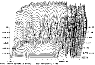

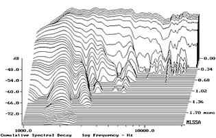

macro, while i like horns, your analogy is faulty; line arrays will give similar performance as horns, re: high spl's, as adequately shown in the links to the pro audio tools posted by scotty.  (i personally liked the alcons' comparison of distortion w/a pro-audio 2" compression driver compared to their ribbon:
2" c.d:
alcons ribbon:
your analogy is faulty because speaker drivers are neither wiolins or cellos.  of course, 30 wiolins won't sound like a cello.  but, based on that logic, no speaker, regardless of quantity, will sound like a cello or a wiolin, cuz it's neither - it's a speaker.   multi-driver speakers in a line array can more accurately portray either a wiolin or a cello, simply because more drivers will increase efficiency & spl while decreasing distortion.
