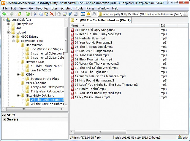

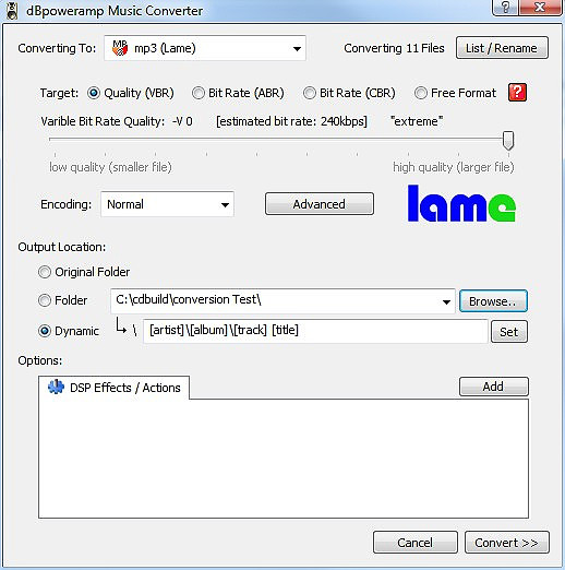

dbPoweramp will maintain all the artist/album/track info IF the original flac files are tagged properly. I just ran a test with 164 tracks from various folders from flac to mp3 and had no problems. But if the tags are not complete then it will not work out well.
dbPoweramp config I used:
resulting tree:
