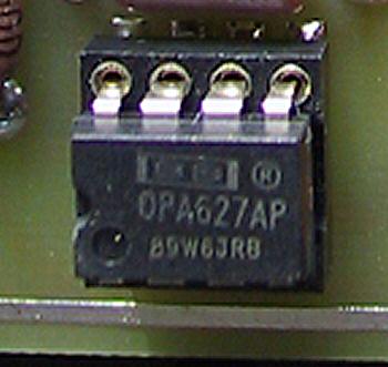

It's strange that the photo cannot be enlarged in that ebay ad.  Even from the small photo, the white OPA627AP label seems awfully too clear and bright.  I seem to recall all my previous OPA627's having a subtler, fainter labelling..  I can check for sure once I get home.

fwiw, here is a shot of my presumed-legit non-ebay purchased 627:

Here is a photo of the Op Amps I bought from AVA.
The chips on eBay look nothing like these.

What I meant was that the eBay chip does not have the "R" after the BB logo. It could mean nothing.
