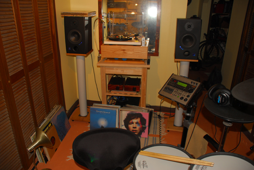

I am running Yorkville YSMp1 powered Nearfieled Studio Monitors.
I originally bought these for a home studio setup. I grew to love the flatness and sound of these speakers. I then bought another pair on a deal ( my buddy works at the plant) to use for my Stereo. Right now I couldn't be happier. I do feel I am missing some perception of space. I think I will move into a larger speaker system fairly soon, I just need some amps for LARGE ADVENTS I picked up (for 32 Dollars BTW).
I think My bass freq do not travel as far as I would like due to the Near field design. Over all the sound is crisp, flat respones, nice bass. I personally prefer a flat respones.
