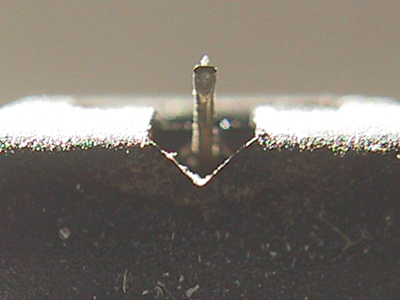

Finally had a chance to try and capture some images today. Thankfully the arm wand is removable (Morch UP-4) so I could put it and the camera on my bench.
These are from a $79 usb camera. It says 200x on the box but that is with digital zoom, not sure what the native resolution is. I'd guess about 50x but I'm not certain.
Anyway, here are a few including a couple with some fuzz on the tip. I touched the tip to my extreme phono "solid state stylus cleaner" and it actually seems to have gotten the diamond pretty clean. Now, about all the dust on the rest of it...
Cartridge is a Scheu-Benz. Basically a modified Benz Glider.

That is pretty amazing. I have never seen a diamond mounted that way, the things I miss with normal vision.
Dan Kolton
  • Posts: 180
Re: USB Microscope?
« Reply #19 on: 25 Sep 2009, 03:10 pm »
I think Mikes photos show that it is extremely difficult to get proper lighting to see stylus wear facets, and that 50x magnification with digital zoom ain't gonna get it.  I'm afraid a good lab type 200x microscope with proper lighting is necessary.  Look again at the results on the micrographia site.
