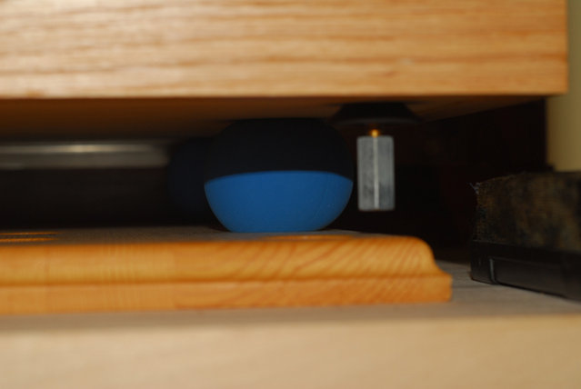

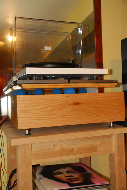

I have a very similar setup for my turntable. The "sandwich" from the top down is
turntable
maple butcher block
squash balls
maple butcher block floatnig on the sand in the sandbox
A little hard to see in this picture, but you can just see the edge of one or two of the balls in front. Very effective isolation, combining mass with the Ginko Cloud isolation technique.
