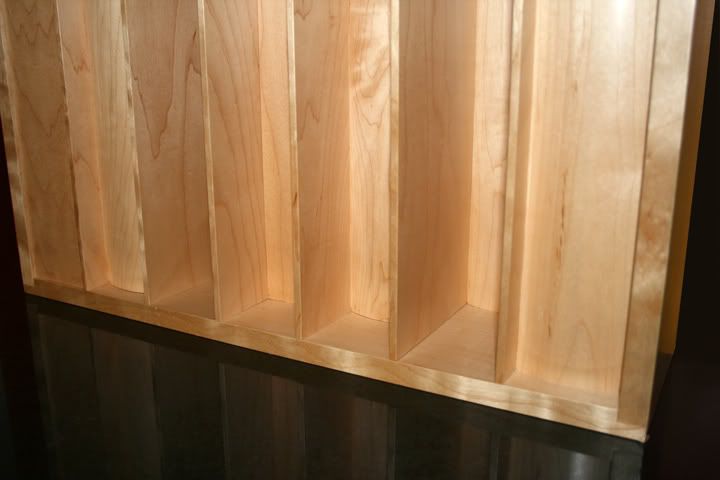

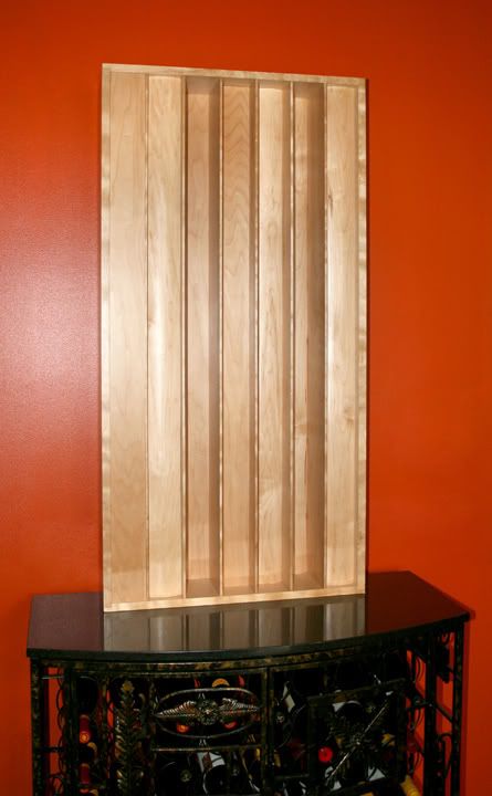

First of all I want to say I LOVE DIFFUSION!!!!!! We sell diffusion and have MANY NEW THINGS coming out. One being this bad boy.  :drool:
BUT can you explain how you would diffuse 40hz??? :scratch: Or why you would?? :D

What I know is that large diffusers do indeed affect the bass range.  It will not happen with a prime 7 diffuser such as you pictured, it must be a higher prime (wider panel) to achieve this.  At this studio the main complaint was a bass standing wave.  I will admit there are two ways to skin this cat, a load of your bass traps would do it, but also one of our larger diffusers properly placed will do the same thing, in this case eliminating the standing wave by breaking it up rather than absorbing it.  A side benefit is that the stereo field and ambience is improved with the diffusion route whereas the bass trap route would remove ambience and sound "dead"  Here is a place that we achieved exactly what we are talking about.....
