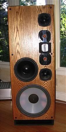

I am looking for some help in possibly picking up some older VMPS speakers.
They are some version of the Tower II I believe.  I am only going off  pictures, which I attached.  Looks like they have a 12" active woofer,  and I am assuming another 12" passive woofer underneath, a 10" woofer, two paper mid tweeters, two smaller tweeters and a super tweeter.  I can't tell if there is a super tweeter on top as well...
Can someone give me some more info on these speakers?   Wattage ratings, approximate manufacture date, MSRP, any thoughts on sound quality or a good price range used?

GOOD FIND!!
However, I don't think these are Tower II's but one of the incarnations of the Super Towers.
They have the same BASS drivers as thr LARGER sub (a 12" and 15" active, and 15" Passive Radiator)

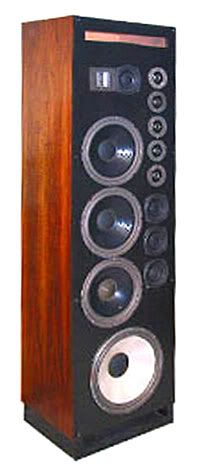

Here is another version of the SUPER Tower R/SE

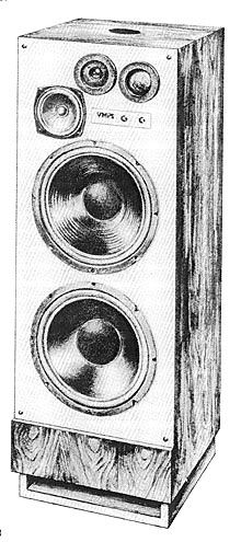

And another (corrected to TOWER II)
And another (SUPER TOWER IIar)
Since these were before my time, Brian can correct the designation code if it is off.

The pencil drawing is of the standard Tower II.
The OP's picture is of the original Super Tower/R, vintage around 1992.  The round corner, veneered front speaker John Casler shows is a STR/SE from 1995 or so.
You will likely have to replace the 15"PR and 15" active due to foam rot.  Modern equivalents/upgrades are available.
