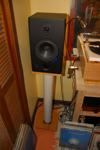

I have POWERED MONITORS for now. Yorkville YSMp1's they are a VERY good affordable near field studio monitors.........$500 a pair.
The specs are:
10k ohms Input Impedance
1Vrms Input Sensitivity.

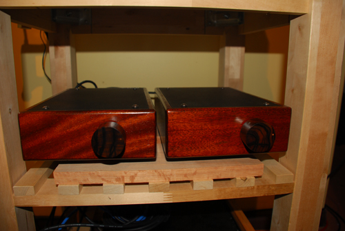

I have the dual mono TVC with 1 XLR input and 2 XLR outputs. I made a DIY PASSIVE RCA switch box with 8 inputs and one output....this output goes to the TVC input.
Doing it this way I saved money on the TVC as I only ordered it with one input. I also now have 8 inputs instead of 3 or 4. This is a route you may want to explore if you are just a little handy with a soldering iron...............See my pictures for Clarification.
