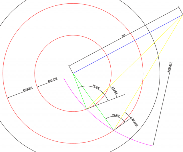

OK I think I've got it  :thumb:
If you're setting out to prove/disprove whether the offset angle is achievable you really need to use a similarly high degree of accuracy when plotting the arc and null points.
I plotted the Baerwald arc for a 215mm mounting distance to an accuracy of 3 decimal places using Autocad (as given by the J Ellison spreadsheet and confirmed with the arc generator software).
Here are the figures from the spreadsheet:
inner null point: 65.998mm
outer null point: 120.891mm
mounting distance: 215mm
effective length: 232.817mm
offset angle: 23.664 degrees
I then measured the offset angle at the null points of 65.998 and 120.891mm and got the correct offset angle at both points!
This clearly shows that it is possible to align to Baerwald IEC null points with an arm of 215mm mounting distance by setting the effective length and offset angle as per Baerwald equations.
Regards,
JaS
PS I've never tried plotting the figures before and always trusted in the original research :oops: This thread has been very informative.

To show that this isn't a one off and the null points on a universal two-point Baerwald protractor are applicable to all arm mounting distances, here's another plot, this time for arms at 222mm (Rega etc), again using the same null points.
Here are the calculated figures:
mounting distance: 222mm
effective length: 239.296mm
offset angle: 22.986 degrees
And here in practice showing that if you align at both null points you will get the overhang and offset angle that Baerwald calculated:
Regards,
JaS
Wayner
Good morning vinylengine!
Your up early! I guess you and I were headed down the same course. Below is a printout of the arm in it's travels across the record surface at some evenly spaced intervals. The 2 red circles are the null points. NO I did not carry the decimal point out to 29 places!! Ha, ha.
The angles are hard to read but this is what they read from bottom to top:
88.242
88.890
89.481
90.006 null point (should be 90.00)
90.453
90.804
91.039
91.097
91.028
89.990 null point (should be 90)
88.817
86.915
83.860
So my 2 null points are off cause I didn't carry the decimal out farther.
Isn't this fun?
Wayner  :o
