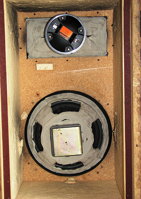

The speakers you heard were my modified Advents. These are using the same drivers and crossover, but a completely different cabinet. The Wharfdale W60D was made from 1968-1972. it was a 12" three way design. The special thing about this series was the cabinet construction. Each one weighs 47 lbs. The back panel is sand filled. The cabinet is finished with English Oak Veneer.
Here is an image from the web of what they looked like stock

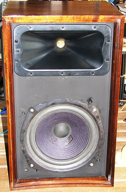

I bought these from my local Goodwill for $30.00 for the pair. I sanded down the cabinets and refinished them with Tung Oil. I cut out the openings for the waveguide and painted the front baffles flat black. I dampened the waveguide and woofers with rope caulk.
The crossovers were scratch built with air core coils and Dayton PP caps. Internal wired with my M-80 cable.
I was able to but out the grille openings to fit waveguide. I think they look great with the grilles on. A real sleeper.
