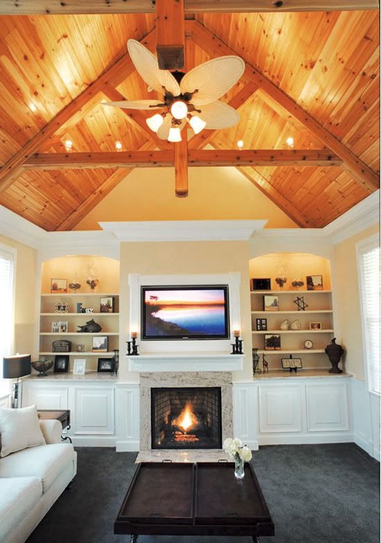

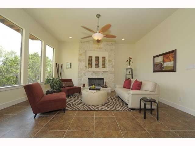

While I do believe it may not be optimal as others have stated I think the design element outweighs the slight inconvience. Here are a couple of photos used to base my decision on our build project. If the hearth is keep at a little lower height the tv will not be that bad. The first photo is a house our builder just finished with a lower hearth the tv niche isnt too bad of viewing stance.
The second photo which will be real close to our familyroom's look is just a perfect design element for tv placement.
I think if done right the design far outweighs the slight inconvience.

Nick, Your 2nd pic is almost exactly what I had in mind with cases or either side of the fireplace. The lower hearth is probably what I will do. Existing hearth in another room is 53" high but I'm thinking about 48" for this room. My 1st pic shows outline of what plasma would look like mounted but it is too high and I will go as low as I can go. I haven't bought furniture yet but am toying with idea of putting couch of 2 - 3" blocks to raise seating height a little if it looks right. I'm pretty much set on it going above fireplace so now it's down to making it as functional and aesthetic as possible.
