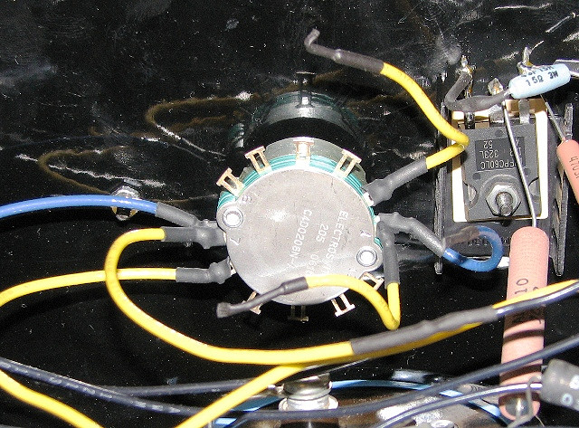

The amplifier that Tyson gave me to repair/rebuild has a switch on the back panel to change between "High" voltage and "Low" voltage. The HV is actually 530 V and the low is 260 V.
After careful examination of the other parts used in this amp, I was curious about the ratings of this switch. The numbers were covered by a blue decal. I peeled the decal off and cleaned up the switch.
This is what I found
It is an Electroswitch C4D0206N sold by Digi-Key for $16.00.
Here is the pdf of the spec sheet for the switch.
It is rated for use to 0.5 amp at 25 volts DC. The switch is only being fed 21 times what it is rated for.
I would be very careful if I owned one of these amps with this switch.
Mr Content
Well this is more serious than just bad wiring. these could indeed kill you. Or they may catch on fire as well. If I had one of these, I would unplug it immediately. :duh:
Mr C :o
Hey!
   Whoa! What the hell was he thinking? :evil:
   I could over look the messy wiring somewhat but using parts rated below needed is just plain stupid  :nono:
