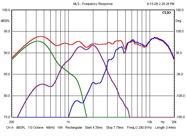

Here is a similar project that one of my students designed (with a lot of advice and help from Danny Richie) for our end of year physics competition.
