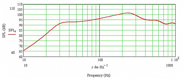

Hi fregs,
I'll give you some flesh on the bones. Clamshell or not, just test, opinions differ !
Three simulations should give a good picture of what to expect.
All are with an H-frame 32" (H) x 16" (W) x 16" (D) inner measures including internal baffle.
1st, No LP crossover applied:

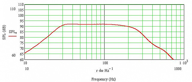

2nd, LP at 125 Hz 2nd order Linkwitz-Riley:

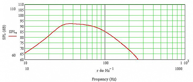

3rd, LP at 80 Hz 4th order Linkwitz-Riley:
