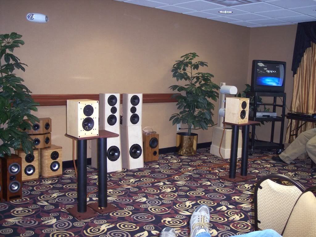

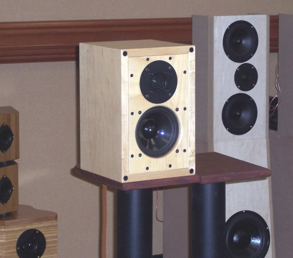

These are little monitors that I designed for myself to yield the best vocal reproduction possible in a small monitor. They aren?t really LS3/5a clones, even though they started off to be that. I compiled all of the data I could round up on the little BBC monitors, including the original BBC design papers. After studying everything I decided to build my own. However, we have learned a lot about loudspeaker design since the mid 70?s and I saw no point in going backwards, so I implemented what I felt were the best techniques that I could use. I really liked the look of the Harbeth monitors so I decided to copy that look, but that?s where most of the similarity to the original ends.
My cabinet is a little larger than the LS3/5a by about ? in. in height and width, and about two inches in depth. Mine are 8?W x 12? tall X 8.5? deep, which is still a pretty small speaker. Regarding the odd look of the front baffle ? a look that people either like or hate ? it simply emulates the Harbeth monitor?s look, which then goes back to the original LS3/5a enclosure which was made the same way with the rear mounted woofer and the screw-down baffle. My cabinet is made of solid hard-maple. In an enclosure this small it is very solid and mine is extremely well sealed. Impedance measurements show that the bass peak is very high Q indicating that there is little if any leakage from the cabinet. They are structurally very strong and these are heavy little things for no bigger than they are.
I actually built three iterations of this speaker using different drivers in each one until settling on my final design. My driver selection changed the crossover topology a lot too. In my final version I tried to stay true to the original woofer by selecting a plastic cone 5?. I went with the Aurum Cantus AC130-F1, which is a very nice little driver ? mica/carbon filled poly cone, rubber surround, cast frame, large motor,  good sensitivity, and a 5mm one-way Xmax. It?s a very beefy little 5?, and better in my opinion than most of the others I have used in this range. It also has an excellent midrange reproduction too, much better than I could get from the Dayton RS150 that I worked with in the first version. I could never get the midrange that made me shout, ?Yes! There it is!? with the RS150. I got it with this driver. It is also much beefier than Seas CA15 and other comparable drivers. The Theile/Small parameters for the woofer are quite a bit different than Aurum Cantus advertises though, but this was no problem because the measured parameters favored a small sealed box, which was what I was targeting for this design to start with.
The tweeter I picked is the Dayton RS28a. This is really an exceptional tweeter, and a real hidden gem among house brands. It is made by Usher and is identical to their proprietary top of the line Be dome tweeter, except this one has a black Aluminum dome (there appears to be some debate regarding the validity of the Be dome anyway). It has a copper sleeve in the motor and two shorting rings and has some of the lowest measured distortion of any dome tweeters out there. It sounds different too ? I think due to the very low distortion. I have a lot of tweeters here (a list of some of the best tweeters made), and this one sounds more like a ribbon on the top than it does any of the domes I have. It comes across as very clean, ?fast?, and detailed with no ?splashiness? on cymbals. I also considered that nice screen protection it has over the dome since this design may someday be used as a pro monitor, and most of them have some kind of protection here.
The advantage it has over the ribbon is its ability to be used with a very low crossover point and a shallower slope. Because this driver had such a low Fs (530Hz) and very low distortion, especially in its lower range, I decided to go with a second order acoustic crossover at 1.8kHz. The woofer?s roll-off is almost a perfect 2nd order response. The tweeter?s is a little steeper than that in order to accommodate the Z offset and bring the drivers into proper phase alignment ? which is almost perfect in the crossover region. The use of the low crossover point yields very smooth off-axis polar response not found in most speakers, so the speaker?s power response is a very smooth, and the off-axis response has no significant peaks or dips. The use of a second order acoustic crossover results in less phase shift overall, and second order acoustic crossovers have a much smoother power response in the 2-4 kHz region compared to LR4.
Where I did remain true to the original LS3/5a spec was in the frequency response. Here it almost exactly matches the BBC specification for the LS3/5a. This employs the BBC ?acoustic scaling? that allows a small speaker to be perceived as more extended than it actually is, while not sounding thick or tubby in the lower mids like many small speaker can sound. I think it works very well and everyone seems to rave regarding the midrange reproduction of this speaker. (At a recent DIY gathering that I took them to some selected them as ?Best Sound at the Show?, so I was pretty happy with that.) It was the midrange reproduction of the original LS3/5a that most reviewers raved about regarding that speaker. Many felt it established a standard for vocal reproduction that continued for many years, some feel it is still the standard.  Above this region the response is almost ruler flat the rest of the way up too, so its upper-end tonal balance sounds very flat and natural on the top end.
The speaker has a sensitivity of 84dB but also has a very easy load to drive with a minimum impedance of 8 ohms through the audio range. For near-field monitoring it has enough output to meet most anyone?s needs. Even in my large family room I can drive them loud enough to be pretty happy. I close-mic?ed it and it was -3dB right at 60Hz, which isn?t bad for a small sealed speaker, especially since it is rolling off second order below that. I probably could have gotten more genuine extension out of the bass by porting it, but I stayed with the sealed enclosure since that was a key element to the BBC monitor and makes it a little more versatile in placement. Also, vented there would probably be a midbass or upperbass emphasis that could become problematic. This speaker?s bass sounds very natural. The second order roll-off blends well with most rooms as well, and adds to the sense that it is more extended than it really is, and that its size would indicate.
I told Jim that I would give him the details if he wanted to build a pair, so if someone wants a pair give Jim a call and we can figure it out from there.
Version one used a Dayton RS150 and Seas 27TDFC tweeter in a slightly different cabinet. It later became my ?Dreydel?.
Here?s a pic of version two using some Vifa OEM drivers. It sounded good, but version three beat it in almost every way.
Here?s the final version with the Aurum Cantus woofer and the RS28 tweeter.
At aDIY gathering
Jeff
