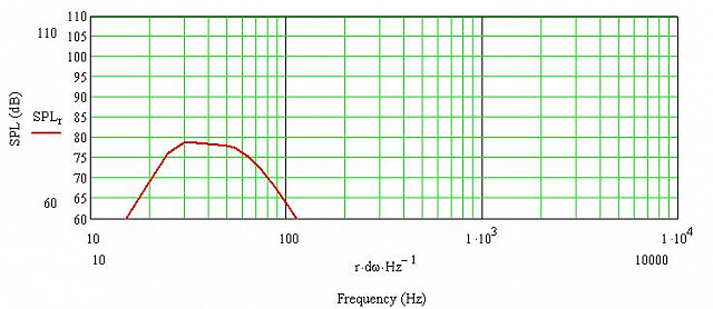

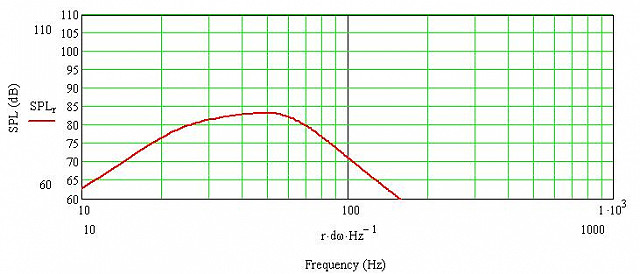

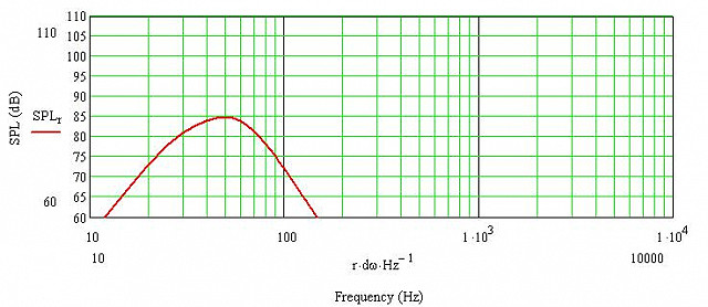

Three simulations to illustrate your test. All with 24 dB/octave Butterworth low-pass filter at 60 Hz. 1 watt power.
First plain Augie 10 " from floor on plane baffle 42 x 24 ":
Second Augie with 9.2 ohm resistance on the same baffle:
Third Augie in H-baffle with inner measures 16 x 16 x 16 " :

Simulations are for the 15" Augie. 10" referred to placement over the floor on the baffle. MJK's now unavailable MathCad models are used.
I ran simulations with your baffle dimensions. They are the same as above !
/Erling

Erling, by your simulations, it seems like a series resistor is giving the most linar output. Before it drops rapidly (where you most likely would not hear anything after all) Would you recomend it prior to the H-baffle?
Cheers
Bj?rn :)
scorpion
Re: Series resistance
« Reply #8 on: 30 Jun 2009, 07:45 pm »
Hi Bj?rn,
I would stick to the H-baffle and use its 5 dB higher output, I think. In the end those are valuable dBs.  :)
But compared to the plain baffle there is very little difference, so this would also be a very good alternative.
/Erling
