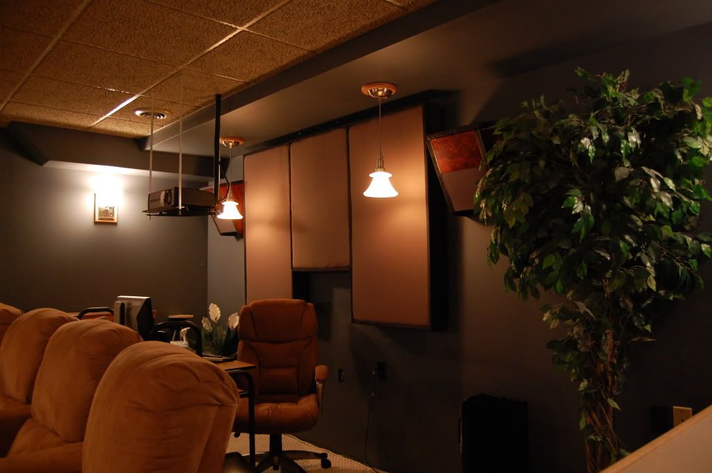

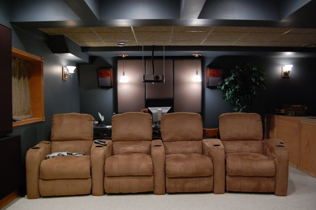

I built mine using 3' "allthread" through aluminum tubing (Home Depot).
It's a tripod like configuration. Nuts on top and "fancy" nuts on the bottom help to adjust the deck height so it's relatively level. The overall height of the allthread and tubing was cut so the deck would hold the PJ at the proper height. The rear support has flexible black plastic automotive wire harness loom around it to encase the six cables feeding video signal.
The "deck" was made from 1/4" luan.
My only regret is with very high SPL and very low content, the tubing rattles against the allthread. But some rubber o-rings in there, or maybe some Gorilla Glue (expands slightly) will stop that issue.
Total cost; Less than $25
For now, the best pictures I have of the setup is below.
If you really really want, I'll take a close-up photo for you.  :wink:
