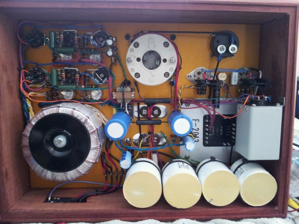

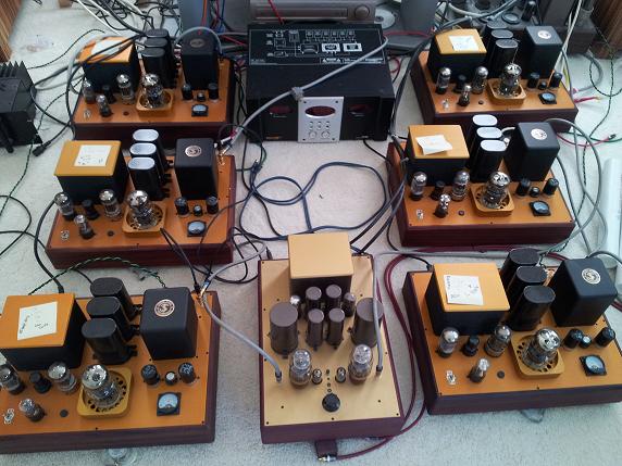

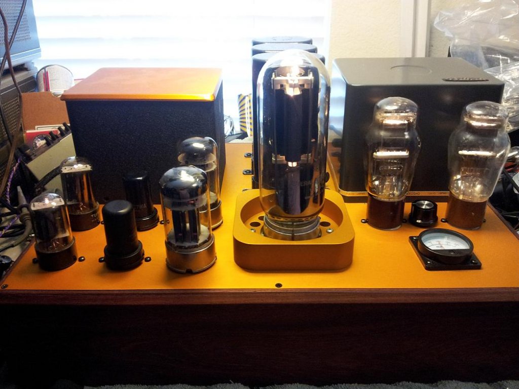

Here is my latest built amp. Another 211 SE (20W), this time using all DHT. Input/Driver is 10Y.

Yes, it is brushed Aluminum anodized like all my previous amp, wrapped with hardwood. This amp was originally intended for 845 and 211 tubes. Due to low mu of 10Ytube, it takes 2.5vrms for max power with 211, for 845 it will takes around 7vrms. This all DHT tube amp is a pain to build because it needed 3 separate heaters, and regulated for low noise, it tooked a while to finish, but is worth it. It serve as an experiment for couple more exotic amp that is in the work.
