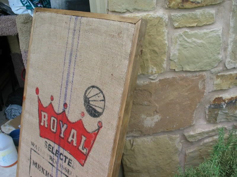

Well I am making some diy panels out of some 2x4 ridgid fiberglass panels a guy gave me. They are only 5/8" thick so I doubled them and plan on using them at first reflection points. I am planing on multicolored fabric but I have some burlap bags from my local bean roaster and thought I would give it a try. I have several different coffee origins and thought it might be unique. These will be for the new house in the game/media room. I not to convined I like them yet, what do ya think?

Cool!! The mitered and stained frames make it look tres chic. Try with some saran wrap or paper  between the burlap and FG if they are absorbing too much high freq. On 1st reflections you might like it better just FG.
:o Dude, that's cool as Hell. You could sell those. That's badass.  8)  aa

The coffee bags are very cool.

Very cool looking! aa  Can't wait for a report on the sound.

Nick,
I think you did a very nice job and produced a fine product.
While not everybody might like the choice of materials, you clearly showed people that DIY acoustic panels need not just be a solid color - bravo.   :thumb:

Thanks! You guys are too kind. I still think they look a little tacky but the investment will be less than $5 per panel. I can always change them out later if they dont look so great in the room. It is a game room so they might work ok.
Here is the next one up, they sell these for a buck at the coffee shop. I will build the second one and bring them in my current room for audition. Thanks again.
