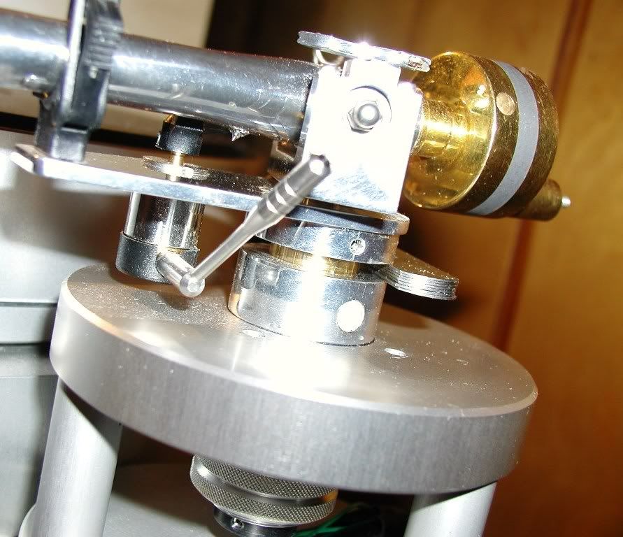

Pics of mine here:
http://www.audiocircle.com/index.php?topic=93000.0
It's just like Photons but with the micrometer lift and a new style arm lock.  I bought mine pre-built.  I think I waited 3 months or so for mine.  They come with two counterweights and a couple different shims to fit under headshell so you can use almost any cartridge with no problems.

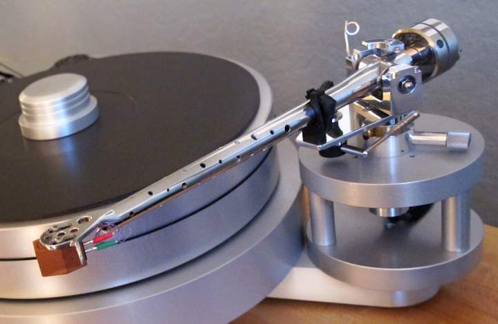

Here is a shot of mine. I have had it since Dec 09.
Regards,
Todd
