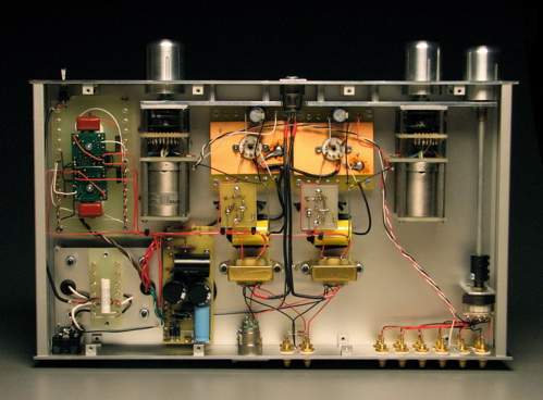

Three for the Circle_the Linestage & Phonostage......
« Reply #10 on: 19 Apr 2010, 07:29 pm »

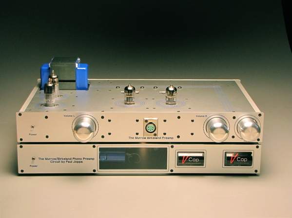

A custom Linestage built for me by Paul Birkeland employing I.A.G. Transformer Volume Controls (Sowter/Shallco "C" series 27 position switch) at the input, and has a hybrid shunt-regulated power supply using EL84 tubes as current sources supplying 6C45Pi tubes which are coupled with TFTF V-caps to MagneQuest B7 all-Cobalt output transformers in  parallel-feed.

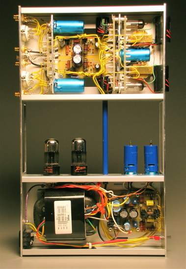

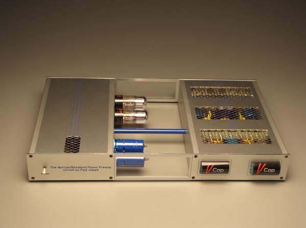

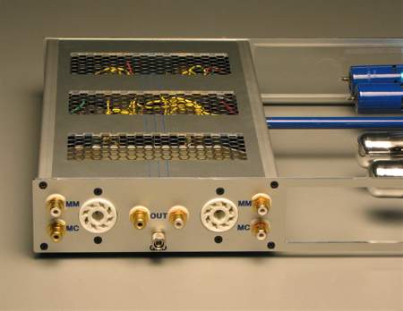

The Phonostage, using the “Eros” circuit designed by Paul Joppa of Bottlehead; with one stage added for slightly more gain and lower output impedance.
The signal side is an EF86 directly coupled to a 6922. The 6922 is cap coupled with a TFTF V-cap to a 6C4 transformer coupled voltage amplifier, which is coupled via another TFTF Vcap to the 125 ohm center tap of the Magnequest Nickel B7. This arrangement is ideal to drive the low- impedance TVC's in the linestage. The dual hybrid shunt-regulated power supply in the left box uses 6X5 rectifiers and 6S4 tubes as regulators.
The octal sockets accommodate Peerless 4722 step up transformers for low output moving coils. When the 4722s are inserted, the MC inputs are used. If MM cartridge or hi-output MC is used, the 4722s are removed.

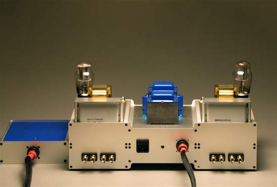

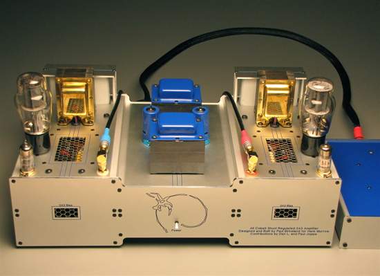

« Reply #11 on: 19 Apr 2010, 07:40 pm »

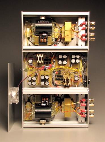

Front view of the 2A3 amp showing separate enclosures for the left and right signal circuits with separate hybrid shunt-regulated power supplies between them in the center chassis with 6S4A’s as current sources.
Rear view showing the output taps and the umbilical for the LED 12V bias supply.
MQ 15335 input transformer at left, MQ filament choke for the 2A3. 6CK5 driver loaded with current source, MQ BCP-16 Cobalt grid choke for the 2A3, MQ EXO-03 plate choke for the 2A3, and 6 uf parafeed oiler near the output taps.
Completely separate Power Supplies for each channel with BH PT-5 transformers feeding separate hybrid shunt-regulated power supplies with 6S4A’s operating in the hybrid regulator circuit. Amp weighs in @ 47 pounds & needs the fan!

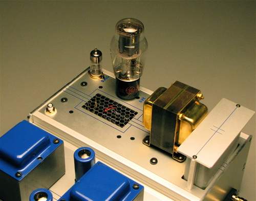

Top detail: 6CK5 driver tube, CuTf V-cap, 2A3 output tube, TFA 2004 Jr. M6/Cobalt parafeed transformers, and Pyramid 6uf oiler parafeed caps.
The whole system is dead quiet, has great dynamics & drive, and gets me back to my huge mint vinyl collection again.
Cheers, Hank
Niiiccee  :thumb:  Where DO you get these beautiful chassis?
BTW, have you compared the VCap TFTF to CuTF in the same position yet?
