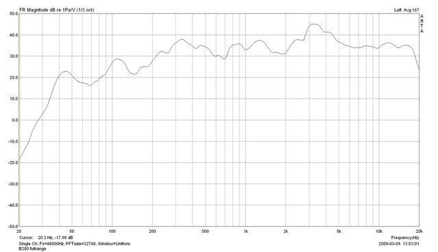

This is what I worked with:
B200s on my old baffle and Eminence Alphas on the MJAO baffle. Let me also present frequency measurement of both speakers. First the B200 fullrange (2.5 m distance on axis):

1st: B200 fullrange alone vs MJAO, no match. B200 thin, a bit darker and at the same time sounding the annoying peak at about 3 kHz.
2nd: B200 + one Alpha15, same result and one Alpha don't really match the sensitivity of B200. So we will need 2 Alphas.

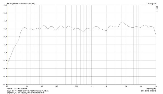

Now I tried combinations of how to passively integrate two Alphas with the B200 as simple as possible to actually mimic Richard's setup and at the same time having a measurable result that showed correlation to what was heard.
I finally reached a setup with the Alphas LP via a 4.7 mH coil and the B200s treated with a notch filter consisting of a 0.14 mH coil and a 16 uF capacitor in parallel connected to B200 like this:
which resulted in this freaquency measurement of the combination:
OK, I thought, I am home. Rulerstraight response and the bothering peak diminished and above all moved out of the fundamental tone range.
So to the listening: Again no match. The MJAO ruled supreme. The Alpha/B200 combination sounded dark and 'flat' in comparison. Is the MJAO really this good ?

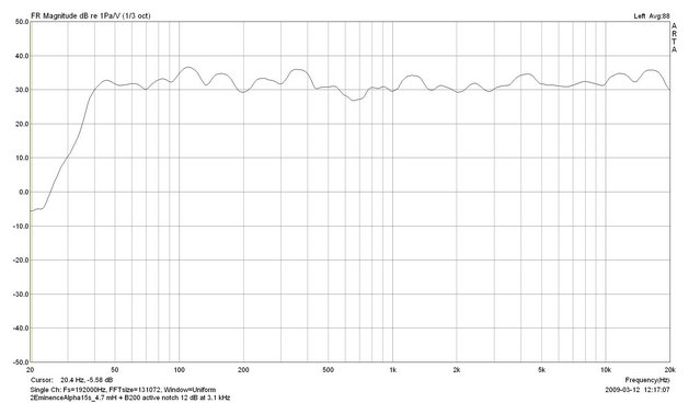

This was really nagging me when I got the idea to test active instead of passive notching. So I brought out my 31-band 1/3 octave old analogical equalizer, put it in the component chain (haven't used it for years) set the 3.15 kHz fader to the bottom. No other correction was done, just mimicing the notchfilter with the equalizer taking down the 3.15 kHz band 12 dB. I measured Alpha15/B200 response again:
That still looked very good but what was the sound like. Totally different. The passive correction components had literally 'killed' the B200. Now active it was showing its full potential and the MJAO really had a challenging opponent.

I went through another round with the B200s to compare the different settings I arrived at. I rank them like this.
1. Active notch - 12 dB at 3.15 kHz 1/3rd oct passband, Q about 4.
2. Simple BSC - LR filter, 1mH - 10 ohm.
3. Passive notch-filter 0.14 mH - 16 uF or B200 just fullrange.
No filter altered the SPL level in comparison among them. The filters were compared in mono to a combination where Alphas were LP with 4.7 mH and B200 running fullrange. I used Leonard Cohen's 'I'm your man' for the evaluation to get a reference which mainly would stay well below the affected frequencies.
Every filter did alter the sonic character more or less. The active filter the least and the BSC-filter a little more. I would choose the active notch as the best for myself.  The third rankings are the worst. I wouldn't go with any of them.
Let me state that I don't really like B200 fullrange on its own. It is overly bright in the sensitive 2-4 kHz region and at times almost cracking/blaring and this goes also for the Alpha - B200 set unequalized for what I hear.
I would consider my passive notch quite mild given the coil value. It shouldn't dig so deep or broad, yet it altered sound character the most. The sound went
much darker and lost dynamics. I wish I had documented my steps a little more scientifically then I would have been able to give a more precise answer to your question. But my gut feeling is that the passive notchfilter affects the B200 more than it should, would it just be altering the responsecurve. I used high quality components for the filter, copper foil inductor and MKP quality capacitors so they in themselves should not really influence the result.
This really interesting question is worth more investigation. But it should be done by someone with very good resources.
BT is certainly the World Champ of Notch Filters but on the German scene also Klang & Ton nowadays seem to apply them to any small response hump.
/Erling

Regarding the passive notch filter I should perhaps make a comment since Pano brings up a very good point.
A notch filter is not very hard to calculate but very hard to get right doing exactly what you want it to do.
Calculations follows this formula:  freq = 1/(2*pi*sqr(C*L)) which after some manipulation could be written freq = 5033/sqr(C*L) where C is measured in uF and L in mH. Here you will find appropiate C and L combinations to apply. Now the higher the L value the bigger notch effect both in magnitude and bandwidth. The bandwidth and magnitude can be adjusted by inserting a resistor in parallel to the coil and capacitor. In reality you will not know which L and C combination to choose so a trial and error process will decide what combination of C and L (and possibly R) values which are the best. You really need to be able to measure response during this process.
For my experiment I started with 1 mH coil value and 2.2 uF capacitor and worked down the scale eventually arriving at 0.14 mH and 16 uF when I was pleased with the measured frequency response. The notch doing its job.
/Erling
