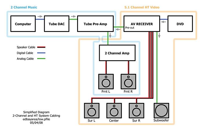

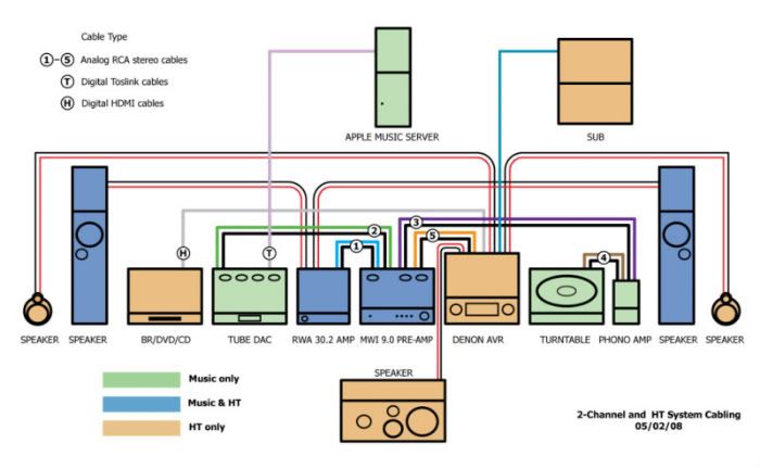

OK back to diagram methods. there are dozens of standard formats. I never use them.
BradJudy I think its best to provide some hierarchal schemes in a diagram (e.g. the DAC is part of a component)
I also found simplification really helps make one diagram communicate more than others - but not down to bare bones. Bare bones tends just to show that things ARE connected. But now why or how.  Color coding and or spacial layout do help to group and or show hierarchy. Also by simplification I mean not including every aspect of a device.
Always ask is the diagram work without any additional written text or verbal presentation.
I have only one old friend back home who I really talk Audio Video with and I started a diagram to show how crazy my setup morphed into since our receiver/ cd player/ bookshelves systems from years back -into a computer based system with wireless control. First I did it literally showing items per room and control methods. A month later I wanted a diagram to show less about the whole house and just show the system components (the system also changed) Then later after completing the second diagram I asked the question what exact question was I trying to answer. And the question was "what is used for 2ch music and what for HT 5.1?" I did the third version in a short time ( <1 hr). It's not perfect but I felt it was more successful than my prior version in better communicating the specific info intended.
Version 3:
Version 2:
Version 1:
Lots of ways to get the job done. Have fun.
cheers, ed

Ed - I like the third version.  It's a nice, simple and clear diagram for the components of a two-purpose system.
