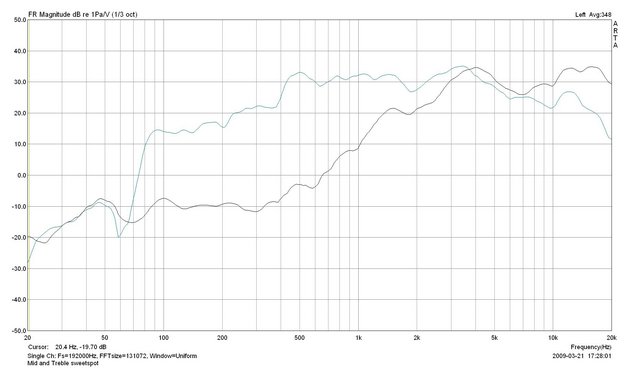

Scorpion - do I want to add a low pass filter to the mid crossover?
Jeff

jkelly,
This is the 64,000 dollar question. My MS-100CHQs fall quite a bit earlier than suggested by the published response curve from Monacor.
Also the DT-28N with 4.7 uF HP is responding a bit earlier than expected. My measurement of mid- and treble-units with their respective filter component is as follows (measurement corresponding to responsecurve in the first post):
I tried some different values for HP capacitor but stayed with 4.7 uF which I thought provided the best integration with the midband.
If you can measure you will of course find out how units behave and adjust accordingly. If you have the feeling that mid and treble overlap too much then a good quality coil of 0.20 to .25 mH for a mid LP ought to solve this issue. I am glad you venture to try this project.
/Erling
