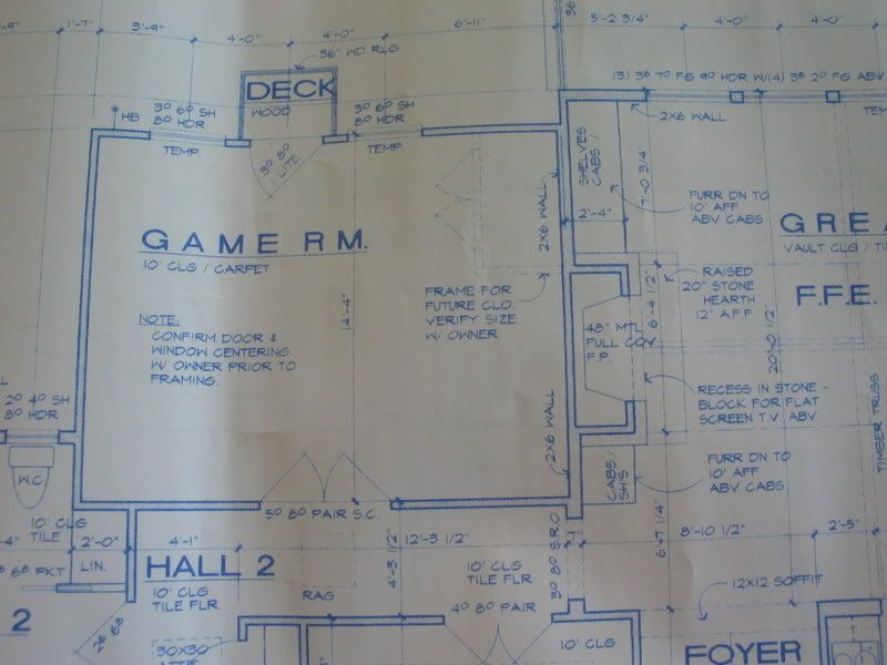

Nick77
Re: NoOb questions
« Reply #6 on: 27 Feb 2009, 07:38 pm »
thanks for the help, attached is a copy of plan. still wonder about window wall needing double rock?
Just for the record there is no shared air space for ceiling, GR has only 12" or so ceiling/roof.
I will be sure to discuss desires with hvac guys.
I guess if i have the framers do a six inch wall across back and side with stagged studs it might be ideal? Thanks again.
