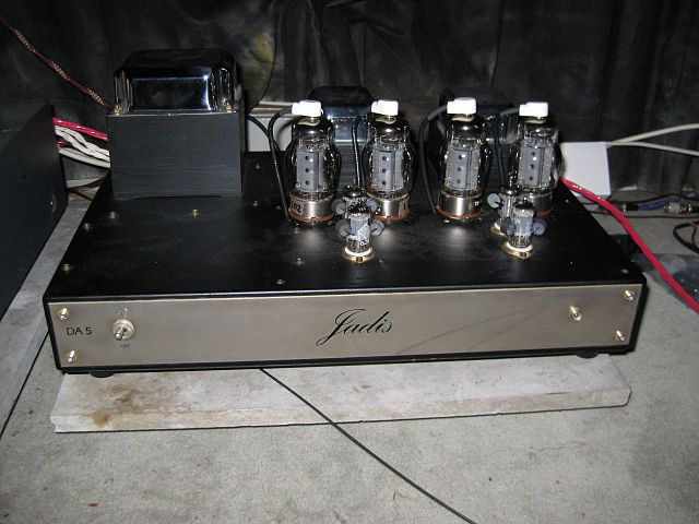

« on: 4 Feb 2009, 12:01 pm »
modded Jadis Da-5 amp
you see the plate cap above
Tungsol TS-5439B a perfect 6550 replacement
but are there other tubes like this?
Cannot find any text about these tubes on Google except from the seller i bought it from
I had to mod the Jadis by lengthen pin 3 to the plate cap on top of the tube
The Da-5 is a 6550 amp
They sound much better more crisp, 3D and musical then the winged C 6550

JoshK
Re: you know this 6550 tube ?
« Reply #1 on: 4 Feb 2009, 02:45 pm »
Did you look in tubedata.org?  Sometimes they have equivalent tube listings.  Not sure how rare those are.  Looks like they were intended for higher voltages (which is the reason for the anode on top) like in transmission applications.   Like a modernization of the 807.
The 807 begat the 6L6, the 6L6 begat the 6550.  The 807 was transmitter tube with anode cap for higher voltages.
« Reply #3 on: 4 Feb 2009, 03:21 pm »
It looks like a sweep tube due to the Compactron socket (or is it Loctal?). The only tube which looks remotely like it is the 6146W and that has an octal base. Of the sweep tubes, a 6JS6C looks close.
Cool tube!  :D
You might consider rewiring the amp for the 6146W if those are too hard to find.
« Reply #5 on: 4 Feb 2009, 03:33 pm »
 Of course it would have to be rewired- goes without saying.  It would need to be rebiased as well- but that's not a big problem. I don't think you'll ever find an exact substitute for that tube. Naturally, the 6650 or KT88 would work great as well.
ltr317
« Reply #6 on: 4 Feb 2009, 03:53 pm »
The photo shows 439B, not 539B.

Radiotubes
« Reply #8 on: 19 May 2010, 06:08 pm »
Here's a 1959 version of the same tube with "solid" black plates.  The plate cap is missing on this example so I pinched an alligator clip to show it's presence.  I'm not certain that "TS-439B" is a good type number, but it's all we have to go on.  Be nice to find a couple dozen :)

Steve
« Reply #11 on: 27 May 2010, 04:55 pm »
Check out this site
http://www.vacuumtubes.com/6BG6.html
35 watt plate dissipation. I use them in my AVA Ultimate 70's.
Ron
The Philips brand 6BG6 has the larger plates and is identical.  I take it the G2/G1 ratio is the same. Nice work.
