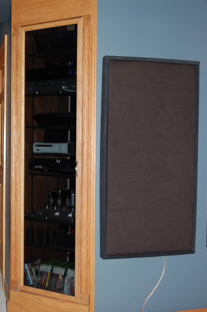

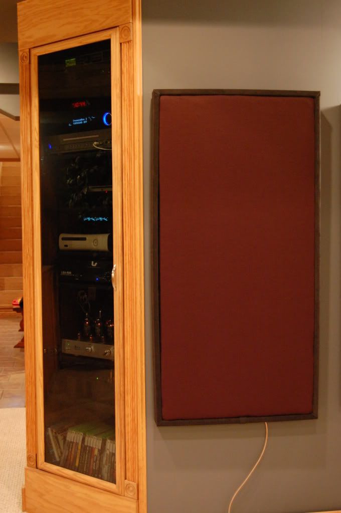

Hey fellas,
Yesterday I was posting pics of my new acoustic room treatments and am getting weird results depending on whether or not I use a flash.
The walls of my room are a dark gray, if I use the factory flash on the Nikon D40, it REALLY accentuates the blue pigment in the paint and looks disgusting.
If I do not use the flash, the black speaker grill fabric looks brown.
So, how do I take a picture that contains both the wall color and acoustic panels in the same image?
Here's the results:
> Flash OFF.
-Correct wall color (well, it's pretty close. In reality it's slightly darker)
-Incorrect panel color. We've all seen black speaker grill fabric. Where did the brown come from?  :scratch:
> Flash ON.
-Almost correct panel color. In reality it "blacker". This image still has a hint of brown.
-VERY incorrect wall color. nasty. nasty blue.

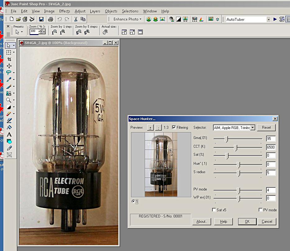

Too bad about the no software part of the deal. RAW is like have a digital negative that you can mess with and convert to a tiff, but the negative never changes. Search Google for Nikon RAW converters, there are some free ones available.
Unzip then Move or Copy the Space Hunter plugin to the plugin folder of your favorite photo editing software. It also works with Jasc Paintshop Pro and probably many others.
As for a gray card, I use a light gray piece of plastic laminate, just plain old white cardboard will work too. The official gray card is for setting exposure before you take a photo. How I use it is to place the gray card somewhere in the photo, just inside the frame so I can crop (trim) it out later.
Open the photo in your favorite photo editor, start the plugin (look in the Effects tab).
Click the lower left hand circle 1
Right click on the white/gray card in the photo. See the white + in Space Hunter? That is where I right clicked.
Ta-da, colors are now correct.
