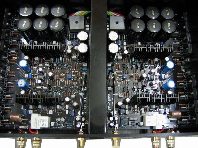

For those who are interested in other audio-gd products, here's another one ... the SA100, 100W per channel amp.
As Tyson has already said ... the quality of the boards is excellent, double sided, heavy foil flash gold plated. This amp uses a pair of 650W trafos and again a very generous bank of power supply caps.
At the moment this is a collection of parts in a box for me but I'll report back when it's all assembled.
