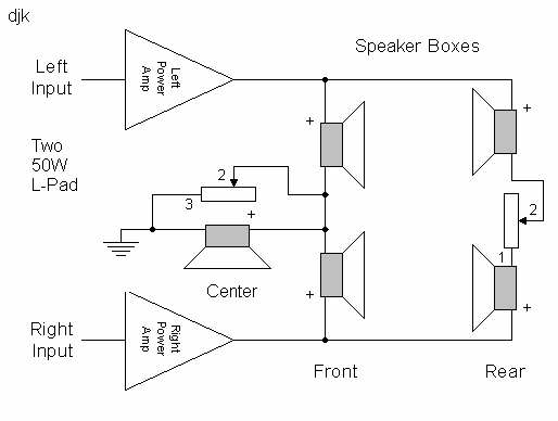

Hi Smile Destroyer,
Don't use that schematic!
That's the data sheet for the LM337.
Actually everything is just inverted so as long as you were careful to invert everything the way it needs to be done for the opposite polarity regulator you would be fine.
I drew a schematic for you showing how to use two positive regulators for a +/- supply and including a series resistor for your multiple low ESR output capacitors.
The bypass for the adjust pin is also included here and it reduces noise by 20db or so.
The image is rather large because I made the writing too small in paint and if I reduced it any more you wouldn't be able to read it so you'll have to scroll it around to get a look at the whole thing.

Wow, thanks Daryl.
The incoming .1uf capacitor I think has to be a 10uf capacitor according to the data sheet if an electrolytic is used.
