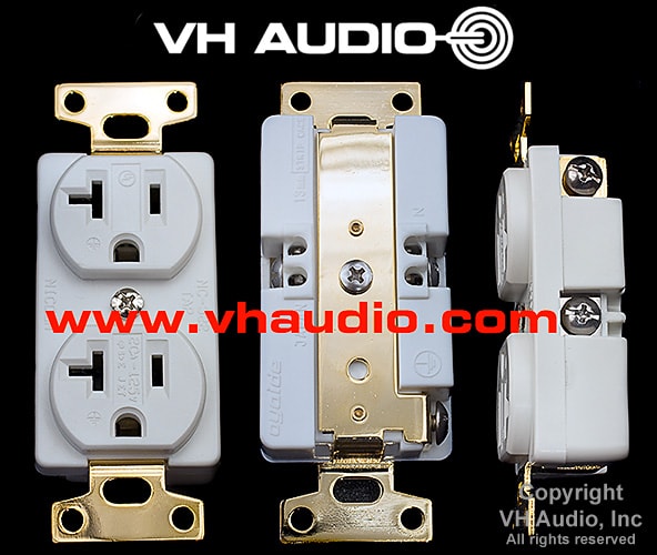

OK, the new 20 amp line (using 10 gauge wire) is installed and things are much better.
I am not losing anything at the end of the run (almost 150' in wire) compared to measurements at the panel.
I decided to go with a pair of Oyaide R1 outlets and while they are silly expensive, they grip like hell and the electrician sure thought they were the best built outlet he has ever installed.   :thumb:
Here is a picture of the R1:
The Furman unit should arrive in the next few days and I will see if that makes any further improvement.
