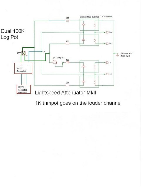

I ran across this thread at diyaudio the other day, sounds interesting.
Basically, you use a LED and an optocoupler to control the volume.  The LED brightness varies the resistance of the optocoupler.
Seems simple, and it is supposed to sound very good.
link to picture
http://drop.io/randytsuch01/asset/cdocumentsandsettingsrtsuchiyamamydocumentsmypictureslightspeedschematicduallogpot
Here is one version I found in the long diyaudio thread.
I think the only hard part is matching opto's, to find a set that will track together well.  You have to buy a bunch of them, and hand match them for tracking, for at least a few points.
Randy

This is from the "inventor" of the lightspeed.  So, the SKA version has a fixed resistor and variable ldr, will the newer lightspeed has two variable ldr's.
Randy

Hi guys, saw this thread when I Googled my Lightspeed Attenuator. Just to clear up the impedance matching issue.
For a good match in a system the Lightspeed Attenuator should see:
1 A CD player or Dac that has an output impedance of less than <1kohm (1000ohms)
2 The poweramp solid state or tube should have an input impedance of more than >47kohms (47K)
When these parameters are met you will have the deepest cleanest bass, most dynamic transients, most transparent sound stage and cleanest sweetest highs, you have heard.
For those of you who wish to build you own, I finally relent and give the details to DIY in this thread.
http://www.diyaudio.com/forums/showthread.php?s=85840c28cfe5fd93fde3bc2b751c8d7d&threadid=80194&perpage=25&pagenumber=1
And for those who wish pictures and more info on my production Lightspeed Attenuator please email me with your email address and I will send it to you.
Cheers George

Looking at the specs of your Panasonic A-105 1st gen dvd player & Monarchy SM-70 pro everything should have been ok.
It is true that the minimum volume is not complete zero, if it was made using the NSL32SR2S in series & shunt (my MkII) version of the Lightspeed Attenuator (and not the NSL32SR3)  then the minimum level is so low in level you almost have to put your ear up to the speaker to hear anything.
All my original MkI (shunt only) I thought I upgraded to MkII a few years ago, but I may have missed this one. If you give me the name of your friends one I can look at my records and see.
As for the ramping up too quick this also says MkI to me, as the volume curve min to max of the MkII is very close to the ideal logarithmic curve. At least you got to hear just how good it was.
If you care to build one below, is the circuit I've used now for the past few years, MKII production Lightspeed Attenuator, as you can see it is double regulated, the 1K calibration (with generator & oscilloscope) trimpot only has to go onto the louder or the two channels.
For some reason (I'm an idiot ) I cannot insert a circuit image? Maybe it's broken and I'm not an Idiot.
Got it!!!!!! man this has to be one of the most complicated forums to post a circuit on.
Cheers George
