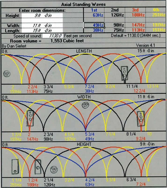

Just for fun I plotted out my speaker and listening positions using the Harman Room Mode Calculator
Though my head is only 1 foot from the wall, the speakers sit at a 2nd harmonic null.
Since I sit centered on the rear wall, I am also in the middle of the 126Hz and 251Hz standing waves but the speakers are at a 3rd harmonic null.
The speaker's port and woofer are 1' and 2' above the floor with my head about 3' up (when not nodding off).
Comments appreciated or add your own graph.

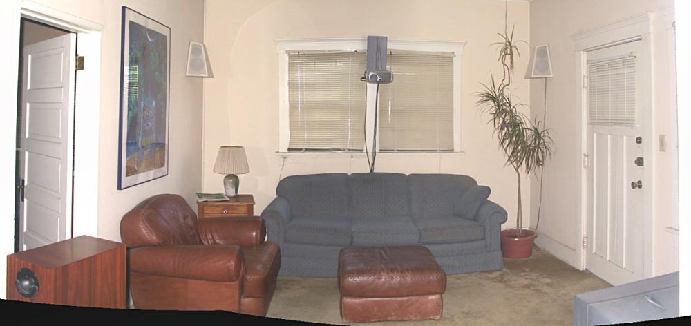

The seating location is not as bad as it looks on paper. It is a small room, if the couch was moved closer to the speakers then the front door would not open all the way. The room also is used as a mini-theater, the projector is above the couch.
A quick pano looking through the kitchen opening.
Yes, all the openings change the room modes, that is why I did the layout just for fun. I am hoping to inspire others to look at their speaker layout in a new way and improve their sound by knowing where the modes graphically lay out. Looking at just numbers is interesting, but doesn't help with speaker location. A 3-D virtual reality model of a room would be a lot more helpful than the too simple 2-D graphs.
I agree with youngho that this is not a good place to sit. If you must sit there, you need broadband absorbers on the wall behind you to reduce the severe comb filtering off that wall. You'll also benefit from bass traps, and broadband absorbers at the side-wall (and ceiling) reflection points.

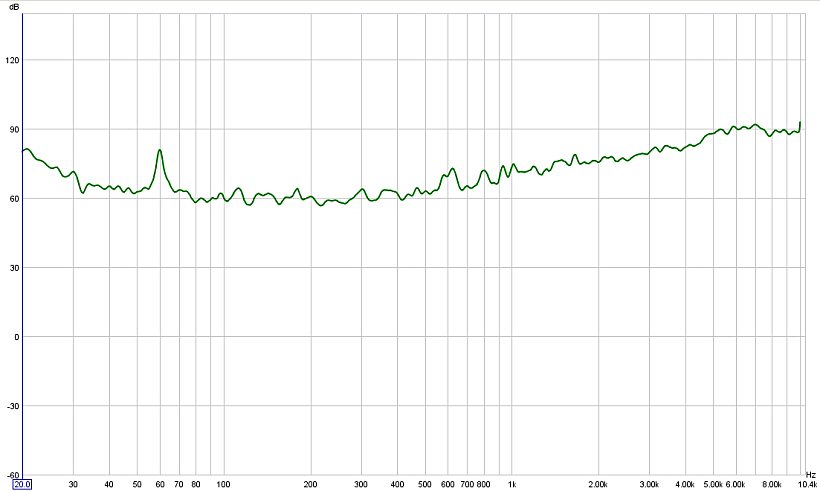

More fun stuff:
I did some tests with Room EQ Wizard software from the Home Theater Shack using a Radio Shack 33-2050 sound level meter.
I set up the meter at the location where my head would be when listening and set the volume to 75-80dB with a 1000Hz test tone at C weighting.
Why is the bass response on the two graphs different? I dunno, maybe because the bottom graph is a frequency sweep so the room resonates differently than with pure test tones.

« Reply #7 on: 6 Aug 2008, 06:01 pm »
Try setting the horizontal scale to just 20-300Hz and the vertical so it's a total of 60db.  Then, take a look not only at the FR but also at the waterfall plot.  That will tell you a lot and give you a lot more detail about what's actually happening.  REW is pretty accurate.  Looking at it's plot, you have over 30db variation from 20Hz-10kHz.
Because the upper graphs looks to be averaged into sixth octaves (not very useful at bass frequencies), where the lower REW graph is at a much higher resolution. Also, as Bryan said, you should adjust the graph to show more of the active dB range vertically.

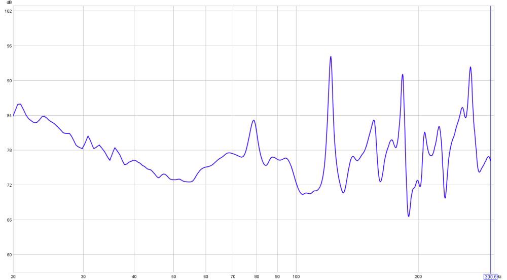

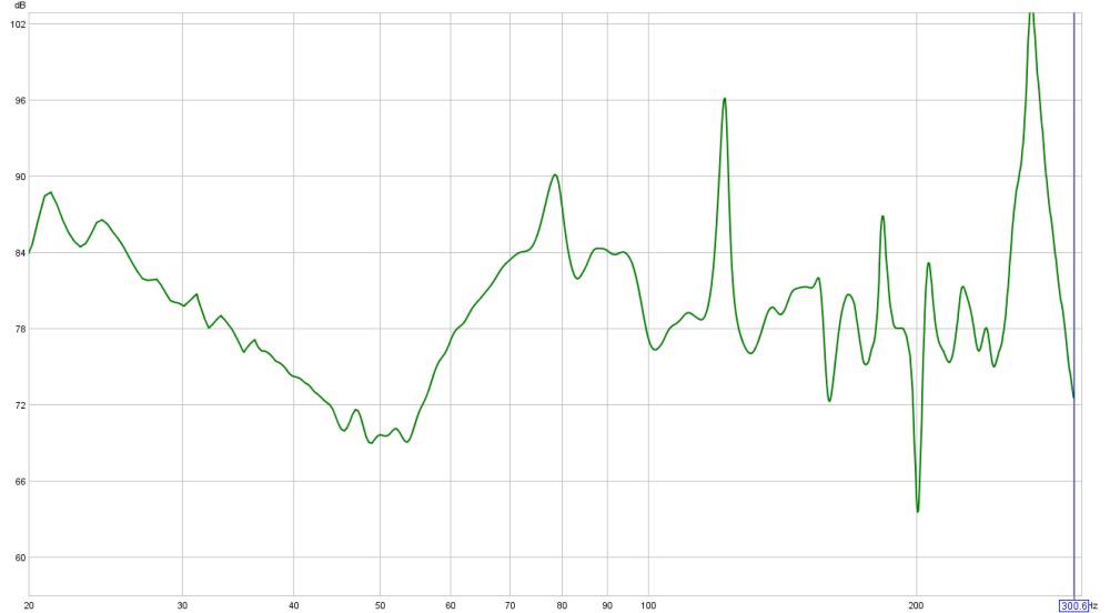

« Reply #12 on: 16 Aug 2008, 10:08 pm »
I slightly changed my speaker locations since the graphs in the post above were made and new batteries in the Radio shack meter now give much more consistent results.
I did a few different setups to see what various mike locations would do the the sound, and and then went back and double checked the readings.
The final results show that even though I sit with my head about 1 foot from the rear wall, that is actually where I get the smoothest response, maybe Joachim Gerhard is on to something.
20-300 Hz, default seating on couch, 1/24 octave
20-300 Hz waterfall plot, default seating on couch
20-300 Hz, meter 42" from rear wall, 1/24 octave
20-300 Hz, meter 60" from rear wall, 1/24 octave
