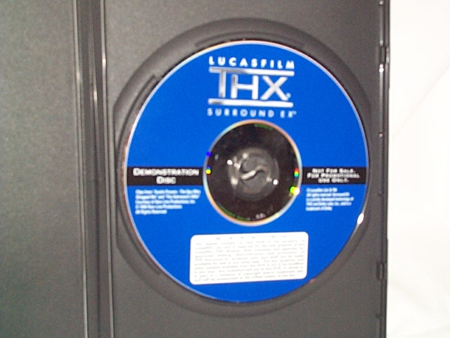

If all you want is pink noise test tones for system calibration the THX EX disc is very, very easy to use. Not to mention it's got pink noise tones for 6.1, which Avia & VE don't have.
But the problem is this. The THX Surround EX demo disc was only given to THX certified HT installers. So you've basically got to get one off eBay.
I'll dig up a pic of the disc so you know what it looks like if you find the need to get one.

Ok, found a pic I had of the THX EX disc. It's a bit fuzzy, but it at least gives you an idea what the thing looks like.
It should also be noted that this disc just came in a plain white paper sleeve. They didn't come in a case as in the pic.

Quote from: bubba966
